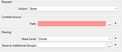

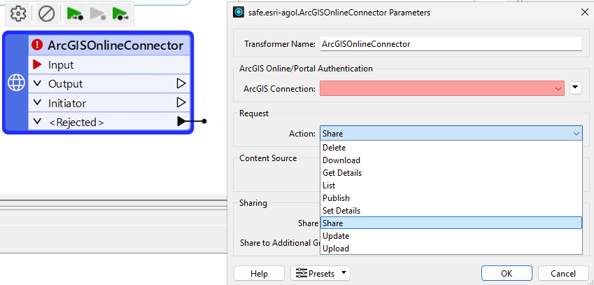

The AGOLOnline/PortalConnector has all these API calls implemented as “actions” into a UI.
For arcgis online you need to Upload, Publish and then Share the item to the Organisation as a whole… or alternatively share just as Owner but add a smaller “Group”
