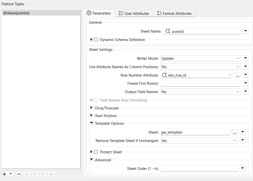

I am trying to use a template file in an excel writer for my data. The data is collected from a number of sites, so I was aiming to use the site id attribute as the sheet name to export a new sheet per site. Unfortunately the template is only being used for the first site which passes through my writer, and the other sheets are unformatted. Has anyone encountered this and found a solution to apply the template to all sheets if multiple are being written in the same feature writer?

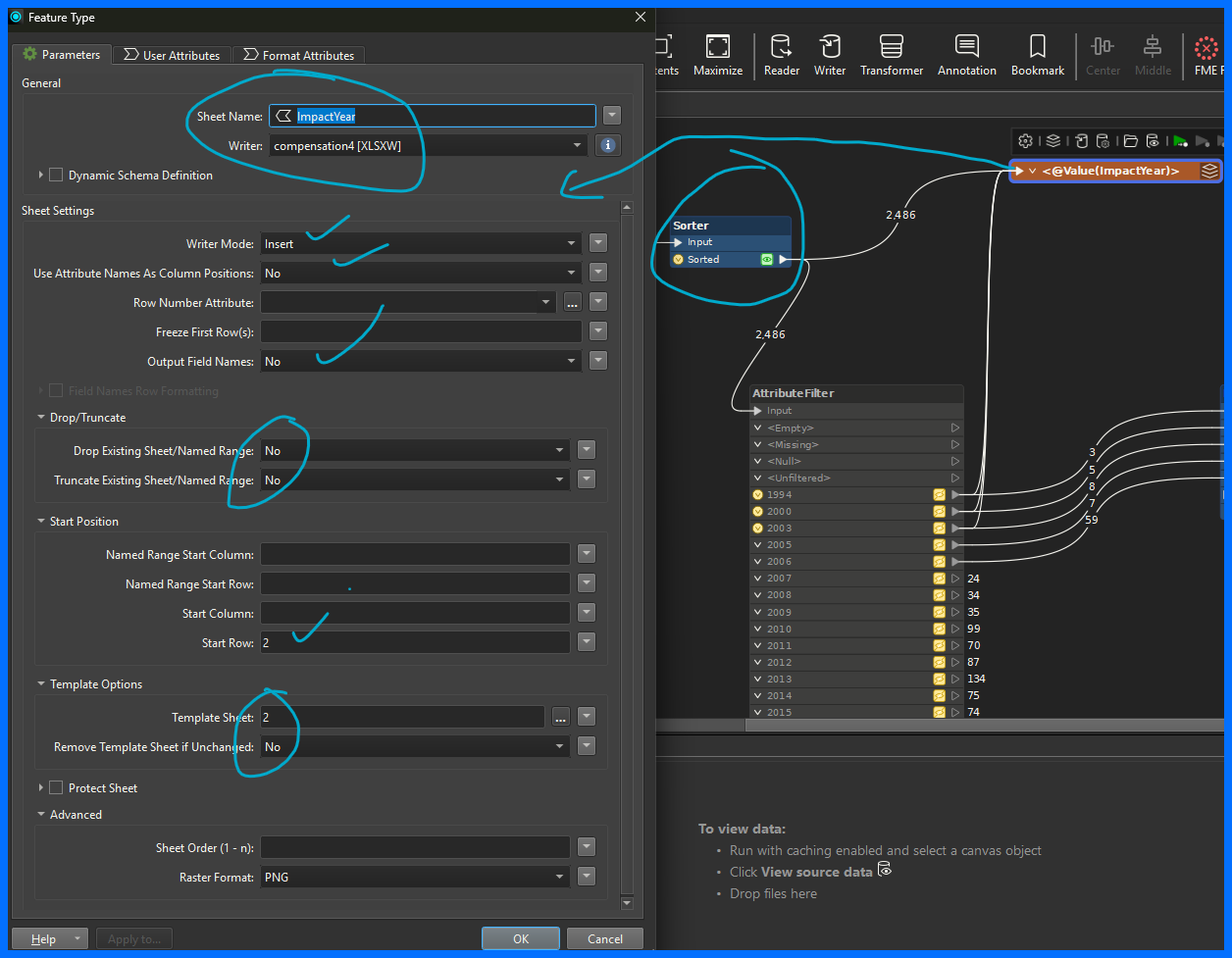

SETTINGS: Note the Sorter before the writer. I sorted the Attribute Variable used to name the sheet (ImpactYear). This will ensure that the she sheets are written out in some kind of order. Key thing is the template sheet name is a number. I entered 2 of the 4 template sheet copies. Just because.

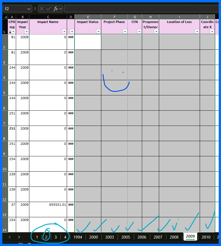

Results: The 4 template sheets came along for the ride (1-4) and there was a new sheet created for each year in the variable

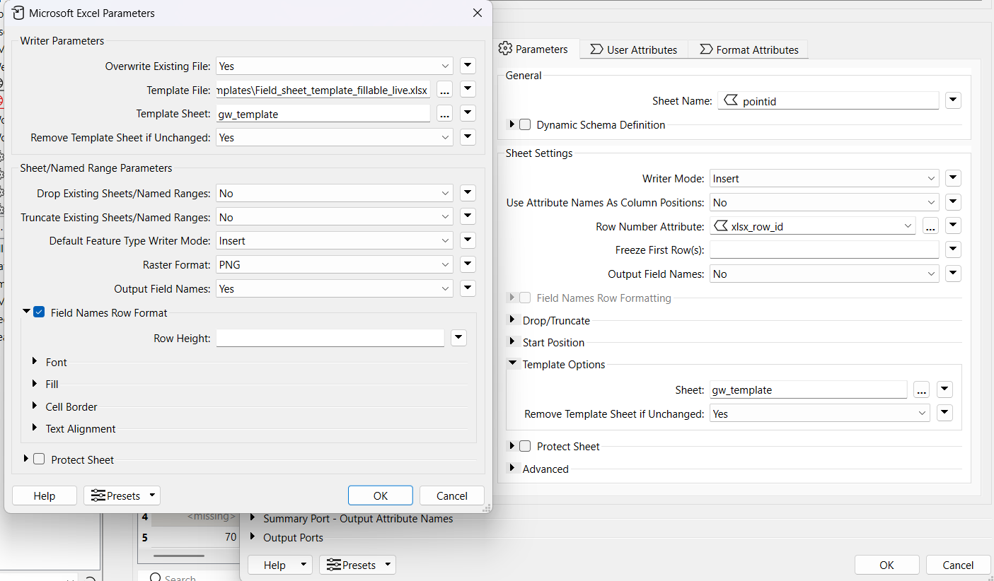

Also, something doesn't quite look right. Are you using the featrewriter? If so click the parameters button and choose yes to overwrite file. And put your path to the Excel template file here.
Thanks @crutledge, yes so I am using a feature writer and have changed this to insert with the template file all set up in the parameters. I have also added in duplicate template sheets, but have to name these differently to the template used (I could maybe try do this dynamically, however the number of sheets required each time will be different) but unfortunately it currently still only formats the first feature
Renaming the sheets 1-4 worked perfectly, and I still managed to write out more than 4 sheets so it is not a case of one template sheet per output either, thank you!! Saves me requiring openpyxl on my FME server machine so this will deliver the output directly from FME
