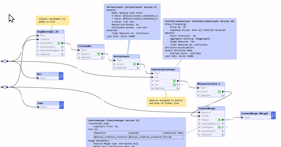

Hi ​@jeff.butler The ListExploder isn’t sufficient because it “explodes” only the attributes but copies the geometry.  You’re right - only the measure from the a random candidate is on the geometry of the MatchedBase feature.  But you could add a VertexExtractor and a PointOnLineOverlayer to get every measure onto the new points, e.g.
Please file this suggestion at https://community.safe.com/ideas !

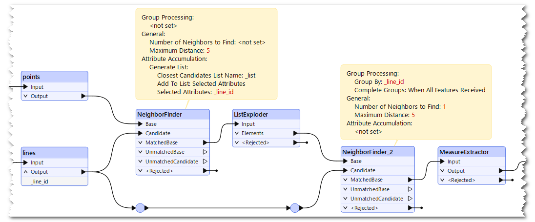

Alternatively, this workflow is also possible. Assuming that the line features have a unique ID attribute e.g. called “_line_id”.

Thank you ​@takashi & ​@DanAtSafe! I tested both suggestions for correct output as well as processing times and while they come up with the same result, ​@takashi’s suggestion was slightly faster using (about 2 min processing about 700k features). I really appreciate your help with this!
