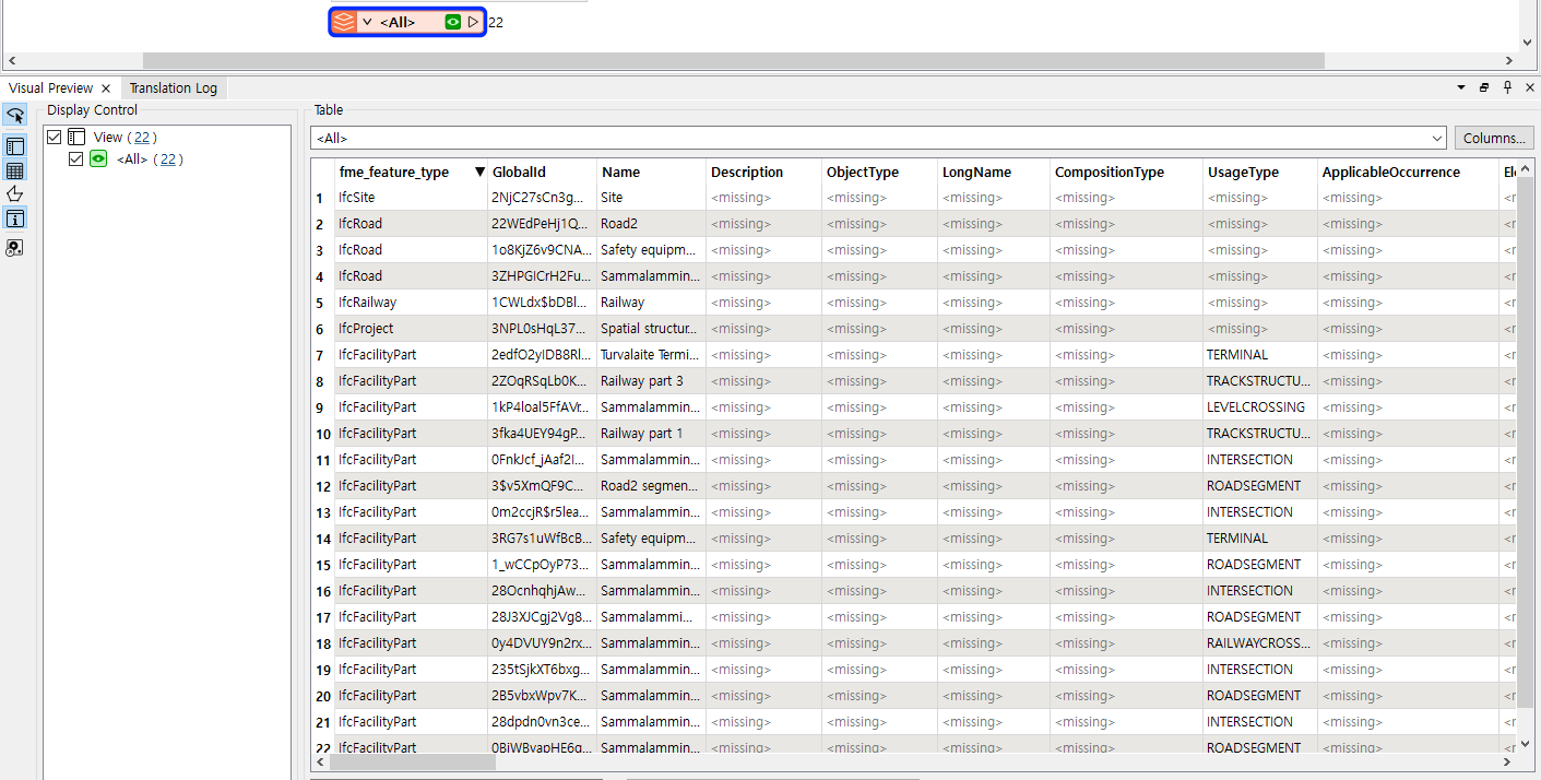

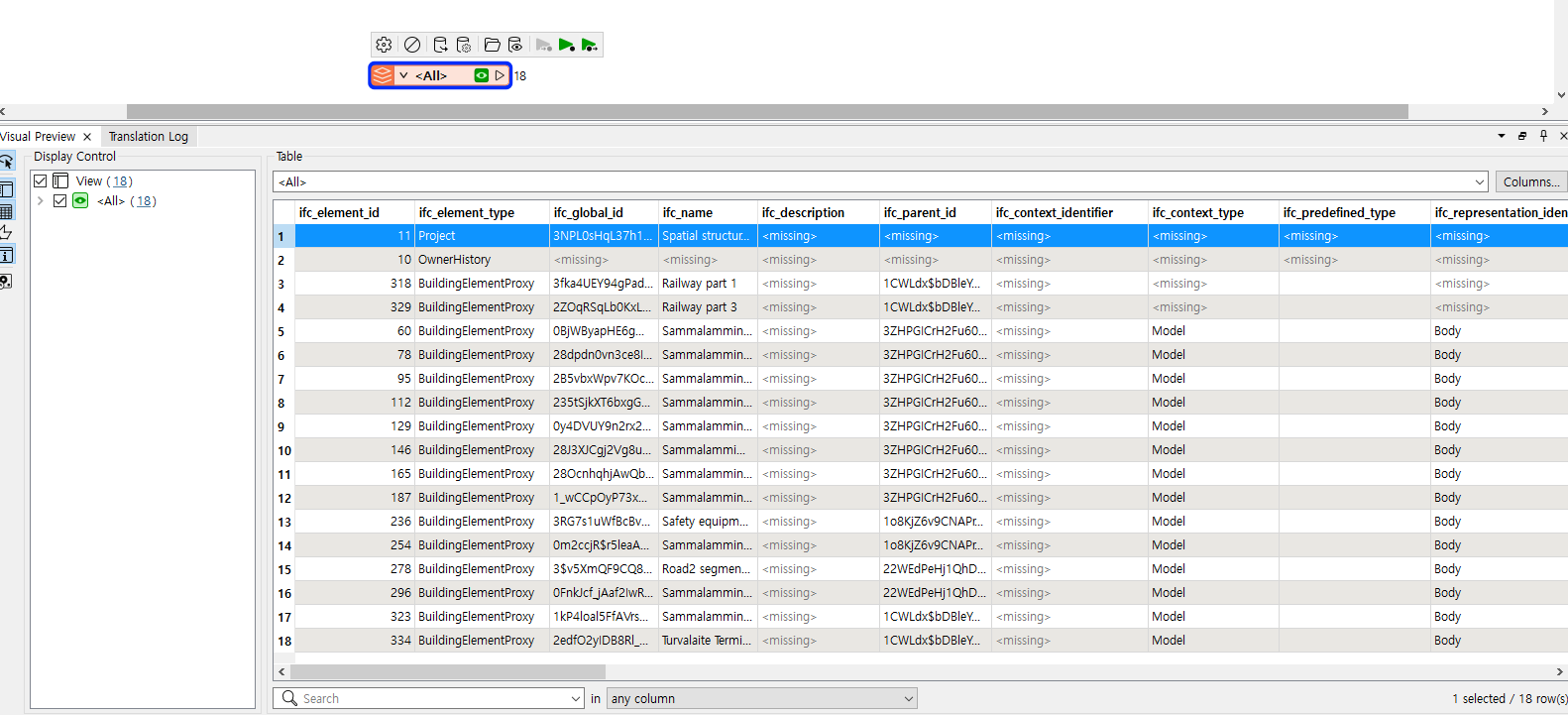

I tested this sample
http://www.bim-times.com/ifc/IFC4_3/buildingsmart/UT_SpatialStructure_4.html
IFC_API reader result:
IFC reader(deprecated) result:

  Thank you for the example and sharing those screenshots!

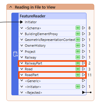

Regarding your observation about the difference between the old and new writers: IfcFacilityPart is defined as an abstract entity in the IFC schema and cannot be instantiated directly. Think of it as an umbrella category designed to group more specific types. Because of this, FME reads it as the generic type IfcBuildingElementProxy, which is what you're seeing in the first image.
However, there is a workaround. You can modify the IFC file to replace IfcFacilityPart with a more specific entity, such as IfcRoadPart. I’ve attached a sample workspace (using the data you provided) that demonstrates how this can be done entirely within FME, using the 2025.1 Beta build 25595.
In the workspace:
  1. I saved the IFC file as a text file then read it using the Text File Reader.
  2. Used an AttributeManager to replace IfcBuildingElementProxy with fcRailwayPart and IfcRoadPart.
  3. Wrote out a new IFC file.
  4. Then read that new file back in to confirm that RailwayPart and RoadPart appear as distinct feature types.
