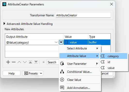

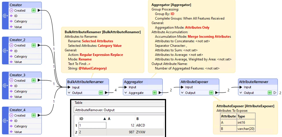

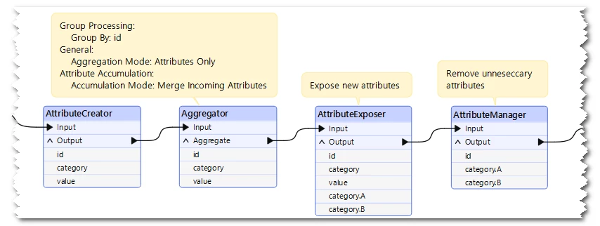

I think you can use AttributeCreator to create a new attribute whose name is equal to the value of “category” and assign the value of “value” to the new attribute, and accumulate the features group by id with Aggregator. Then, expose the new attribute names with AttributeExposer if necessary.
See the screenshot to learn more. Assuming "category.A" or "category.B" is the value of the attribute called "category".

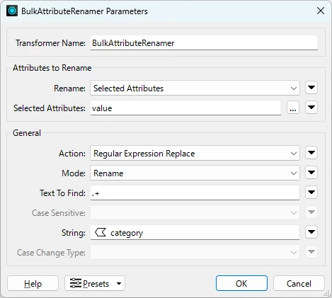

You can also use BulkAttributeRenamer instead of AttributeCreator to replace the attribute name “value” with the value of the attribute “category”.

Hi ​@mzuer ,

Neat trick, I never knew the BulkAttributeRenamer could be used like this.
Don't forget to use an AttributeExposer afterwards.
