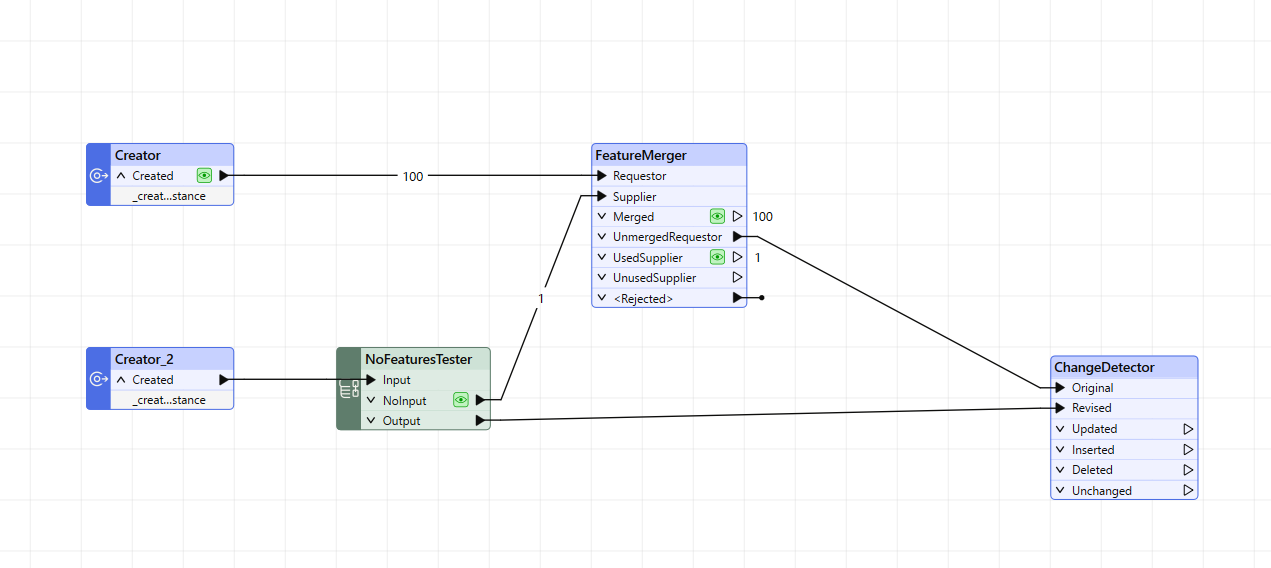

Occasionally the upstream service from external provider might not retuning any features, in those cases, there will be 0 features going to the “Revised” stream. How do I stop ChangeDectector instead of keep running and delete existing features.
Best answer by _jacques_

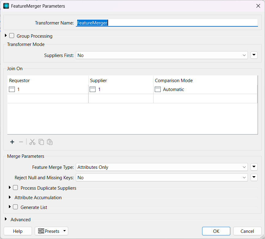

You could probably do something with the NoFeaturesTester transformer from the Hub, published by Safe Software. I quickly put together a demo using a NoFeaturesTester together with a FeatureMerger set to merge 1 = 1. If there are no features entering the NoFeaturesTester, then there will be a single feature going up to the FeatureMerger, which will stop the features from reaching the ChangeDetector.
Good luck!
/Jacques

​@_jacques_  Thanks, works perfectly.
