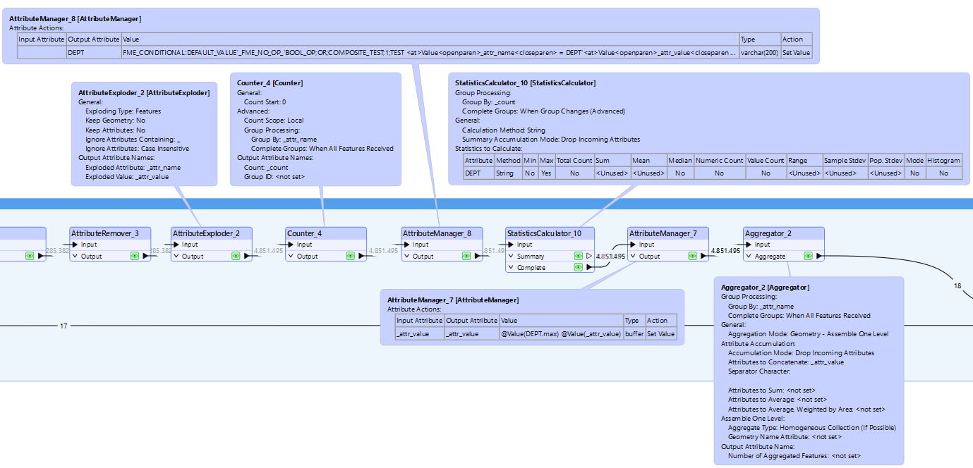

Hi ​@takashi ,
the names are completely unpredictable. That said, i came up with a solution which works well enough for me.
