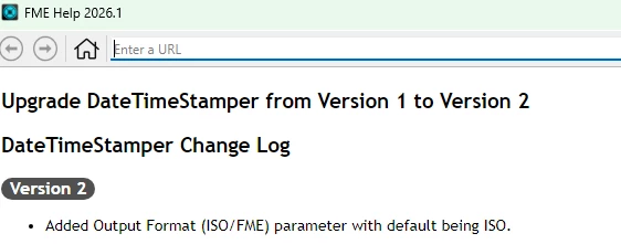

Another unexpected datetime issue I’ve encountered, is upgrading DateTimeStamper now enforces a default ISO output. Most of my downstream processing to these highly used transformer… expected it as FME date output… so I have alot of broken workspaces should I upgrade transformers
bulk transformer upgrades default to ISO, no user choice unless single transformer upgrade
Now that you mentioned it: I’ve ran into that one as well. I write out logfiles quite a lot (for keeping track of changes made by nightly processes) and I always use a DateTimeStamper with the date to Fanout my logfiles to yyyymmdd_<logfile_name>. That suddenly got messed up indeed…
But you’d think that something like that would then be enforced everywhere, and apparently it isn’t.

FME 2026.1 moved to ISO 8601 datetimes across the board, so new Date Only user parameters now store as 2026-01-01 instead of the old FME format 20260101. It's logged under FMEFORM-13030. The DateTimeStamper surprise you and j.botterill both hit ties back to a related open item, FMEFORM-37767, about bulk transformer upgrades silently defaulting to the new format.
