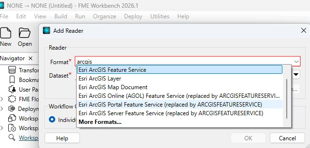

In 2026 build, the new ArcGIS Feature Services package replaces the older Portal Feature Service reader. The change is well documented in the article Working with Esri ArcGIS Feature Services in FME – FME Support Center

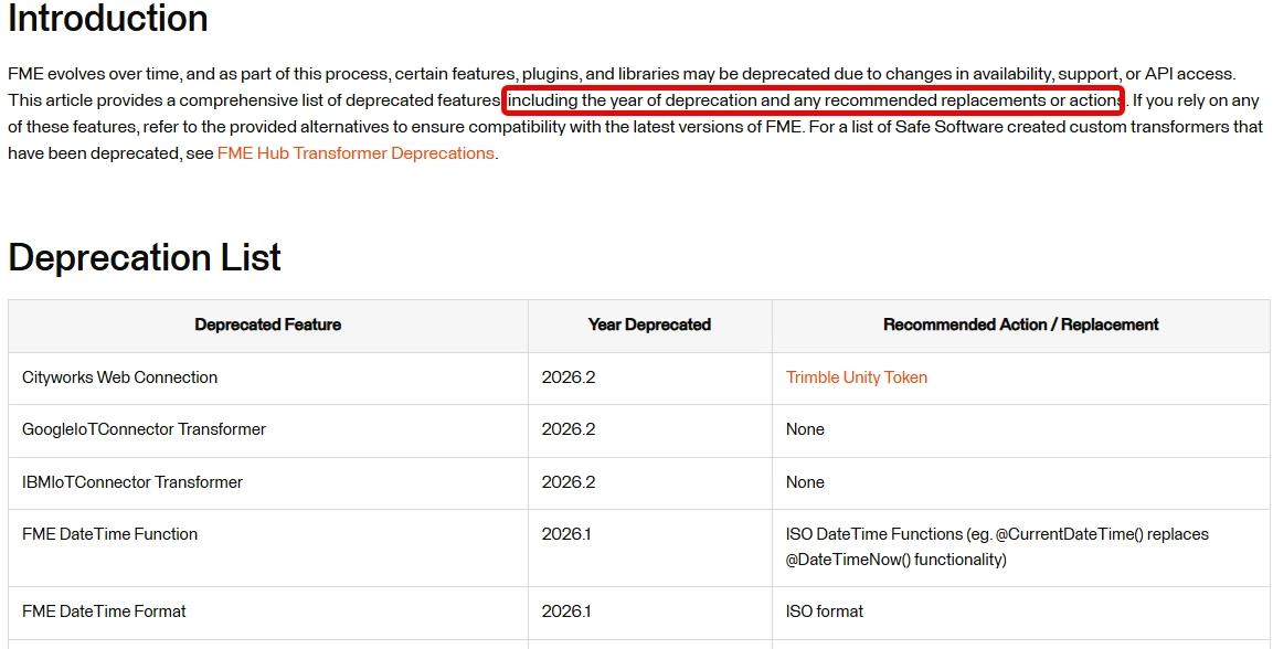

My question to a Safer is, how/when are 2026 deprecated formats like PORTALFEATURESERVICE listed in the article FME Deprecations – FME Support Center.
the new unified ARCGISFEATURESERVICE package replaced arcgis x feature service formats
Can these now older ArcGIS Feature Service formats be added to the article; along with Recommendation actions listing out sections/bookmarks from the support article
Question about deprecations article
  1. When do components get included to the article and how is it updated?
  2. is this a manual task or can the development team inform earlier updates when components are planned to be replaced?
Recently for example, randomly FME Date Time functions got added to the article, where it was listed as affecting in 2026.1…. yet we were already at 2026.2 release?
FME DateTime functions and format defaulting to ISO 8601
This would have been much handier to know about these ahead of time, earlier

Hi ​@j.botterill, thank you so much for this detailed feedback! Currently, the process for these updates is manual, and we are looking into ways to improve how we update the Deprecations article and communicate changes, such as sharing the DateTime changes earlier and making them clearer.
In the meantime, your note about PORTALFEATURESERVICE and the other legacy Esri Feature Service formats not yet being listed is a good catch; I will make sure that gets passed along.
