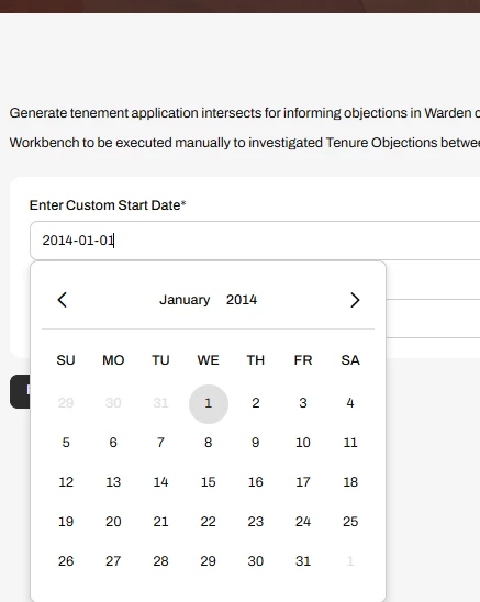

Today I placed a default value for a date User Parameter as
@DateTimeFormat(@DateTimeAdd(@DateTimeNow(),-14,'day'),'%Y%m%d')
essentially the date widget in FME flow would go back 2 weeks, this used to work fine….
But alas, in 2026 it is now returning something wild

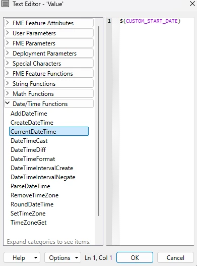

Am I supposed to use this now ?
a new datatime function?
Here is the help documentation https://docs.safe.com/fme/2026.1/html/FME-Form-Documentation/FME-Form/!Transformer_Parameters/Date-Time-Functions.htm
When we upgrade transformers, will the @DateTimeNow() functions get transformed into @CurrentDateTime ?
Also the @DateTImeAdd is this going to be converted to @AddDateTime
I can see the syntax
@AddDateTime(<datetime>,<interval>)

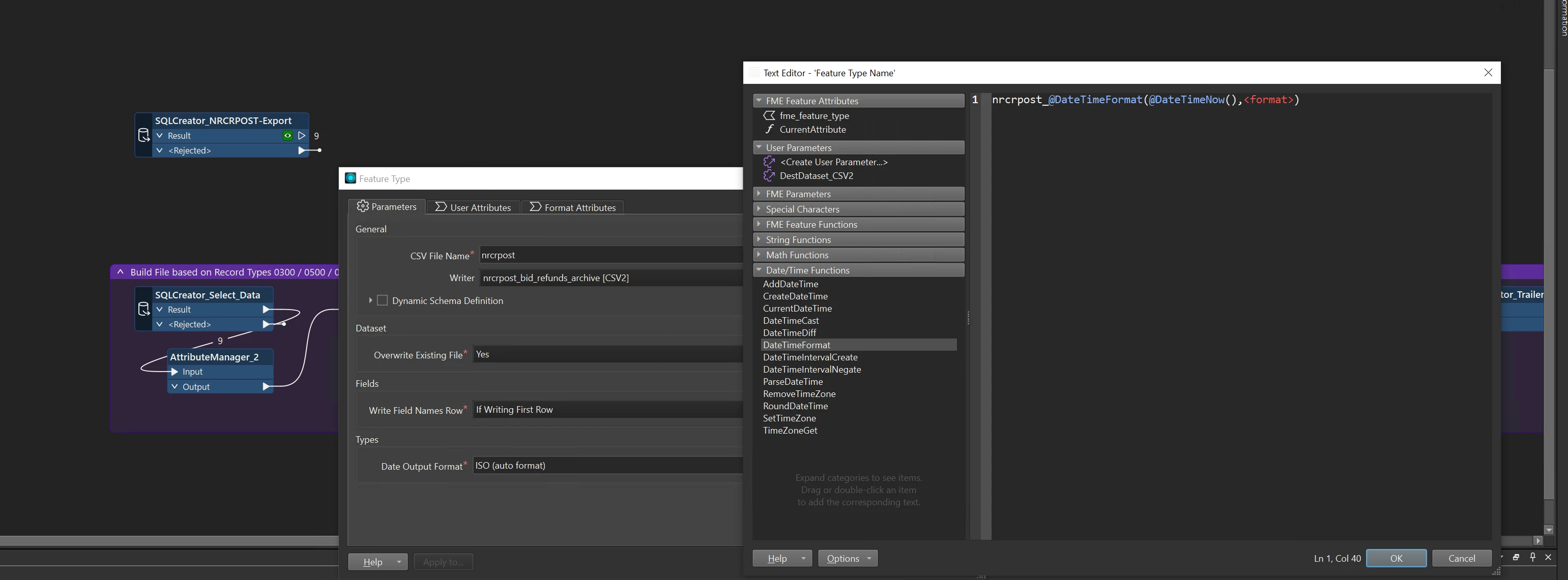

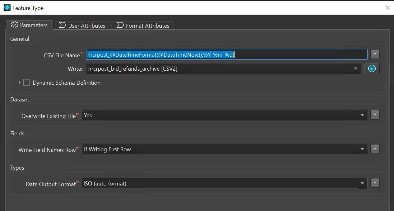

So this
has become
@DateTimeFormat(@AddDateTime(@CurrentDateTime(),P-14D),'%Y%m%d')

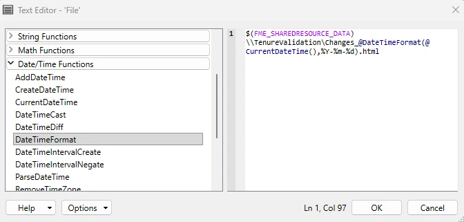

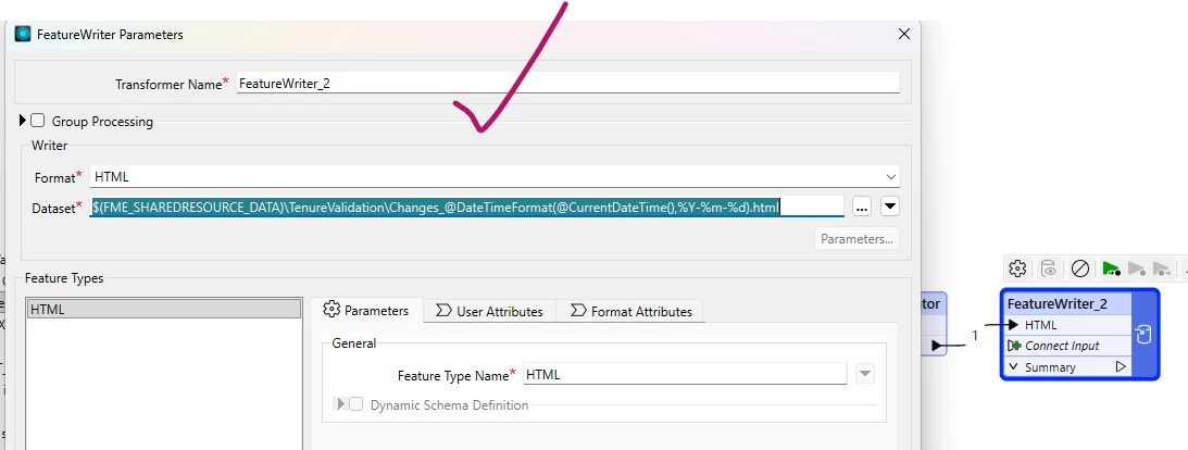

I’m struggling to use the current/datatimenow function in a dataset path. For example I have a writer with UserParameter and the function in the path
$(FME_SHAREDRESOURCE_DATA)\\TenureValidation\Changes_@DateTimeFormat(@CurrentDateTime(),%Y-%m-%d).html
@DateTimeFormat(<datetime>,<format>)
documentation https://docs.safe.com/fme/2026.1/html/FME-Form-Documentation/FME-Transformers/!Transformer_Parameters/Date-Time-Functions.htm

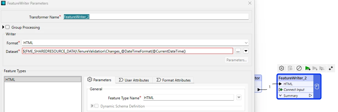

before… validates so I hit OK on the writer
return and open it again, its truncated…. that’s no good
I read the documentation again, found this note
So it needs encapsulating in brackets? “ “
only the text editor does this… not if you manually type in the DateTime function
so it must include "$(DestDataset_GEODATABASE_LocationIssues)\TenureValidation\Changes_@DateTimeFormat(@CurrentDateTime(),%Y-%m-%d)"
question
why does it validate as true without the “ “ then ?
the consequence is it will truncate the path back to the new CurrentDateTime
