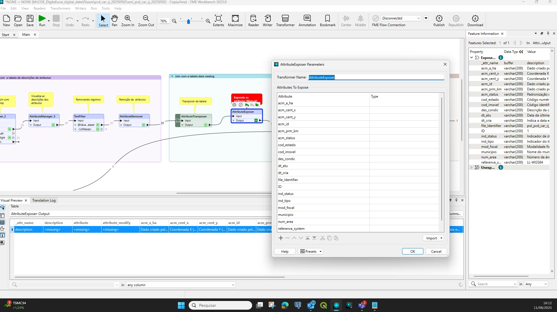

How can I automatically add all attributes in AttributeExposer after AttributeTransposer without having to manually select each one?

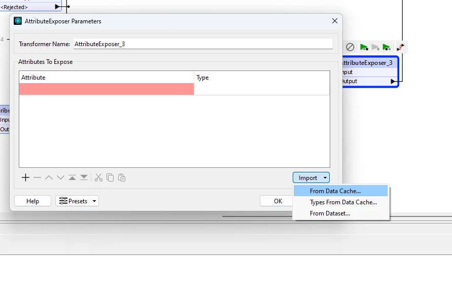

When you got feature caching activated, try this:
This approach works dynamically. For example, when reading multiple shapefiles, can I be certain that, for each execution of the workflow for a shapefile, the cache will be used correctly?
max_h
Forum|alt.badge.img+39
  • Aug 13, 2025 5:51 AM UTC
Sadly no, this would be a manual approach, check this topics for a dynamically solution:
https://knowledge.safe.com/questions/32483/dynamic-attributes-in-custom-transformer.html
Dynamically expose attributes | Community
Hope those help in your case!
