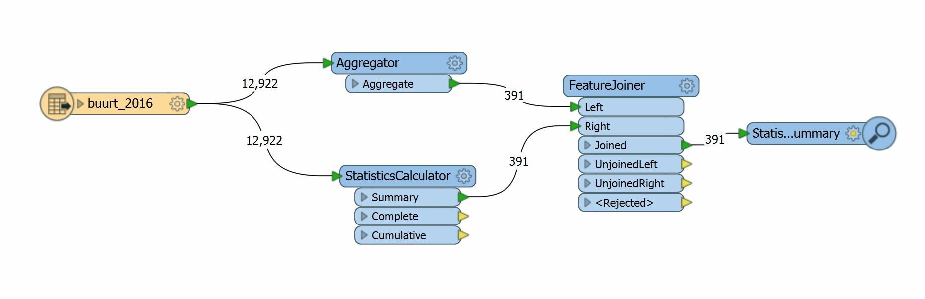

  • August 24, 2018
Probably you use the Summary port. If you want the geometries then you have to use an Aggregator (with the same group by) and a FeatureJoiner to add the summary of the StatiscticsCalculator to these geometries. Good luck!
