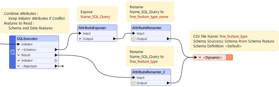

Hi ​@tthach830 ,
SQLExecutor creates schema feature(s), but “fme_feature_type_name” attribute in schema features and “fme_feature_type” attribute in data features both stores text string "SQLExecutor" by default.
If you would like to make destination csv file name the value of "Name_SQL_Query" with the dynamic schema mechanism, you will have to modify those attriute value appropriately.
A possible way is:
  • SQLExecutor : Set "Keep Initiator Attributes if Conflict" to the Combine Attributes parameter to propagate "Name_SQL_Query" attribute to output features, set "Schema and Data Features" to Features to Read parameter to read both schema features and data features.
  • Schema features from <Schema> port : Expose "Name_SQL_Query" attribute with AttributeExposer and then rename it to "fme_feature_type_name".
  • Data features from Result port : Rename "Name_SQL_Query" to "fme_feature_type".
  • In the CSV writer feature type, set general parameters like below.
    • CSV File Name : fme_feature_type
    • Dynamic Schema Definition : <check>
    • Schema Sources : "Schema From Schema Feature"
    • Schema Definition Name : <Default from CSV File name above>
See also the screenshot below.
