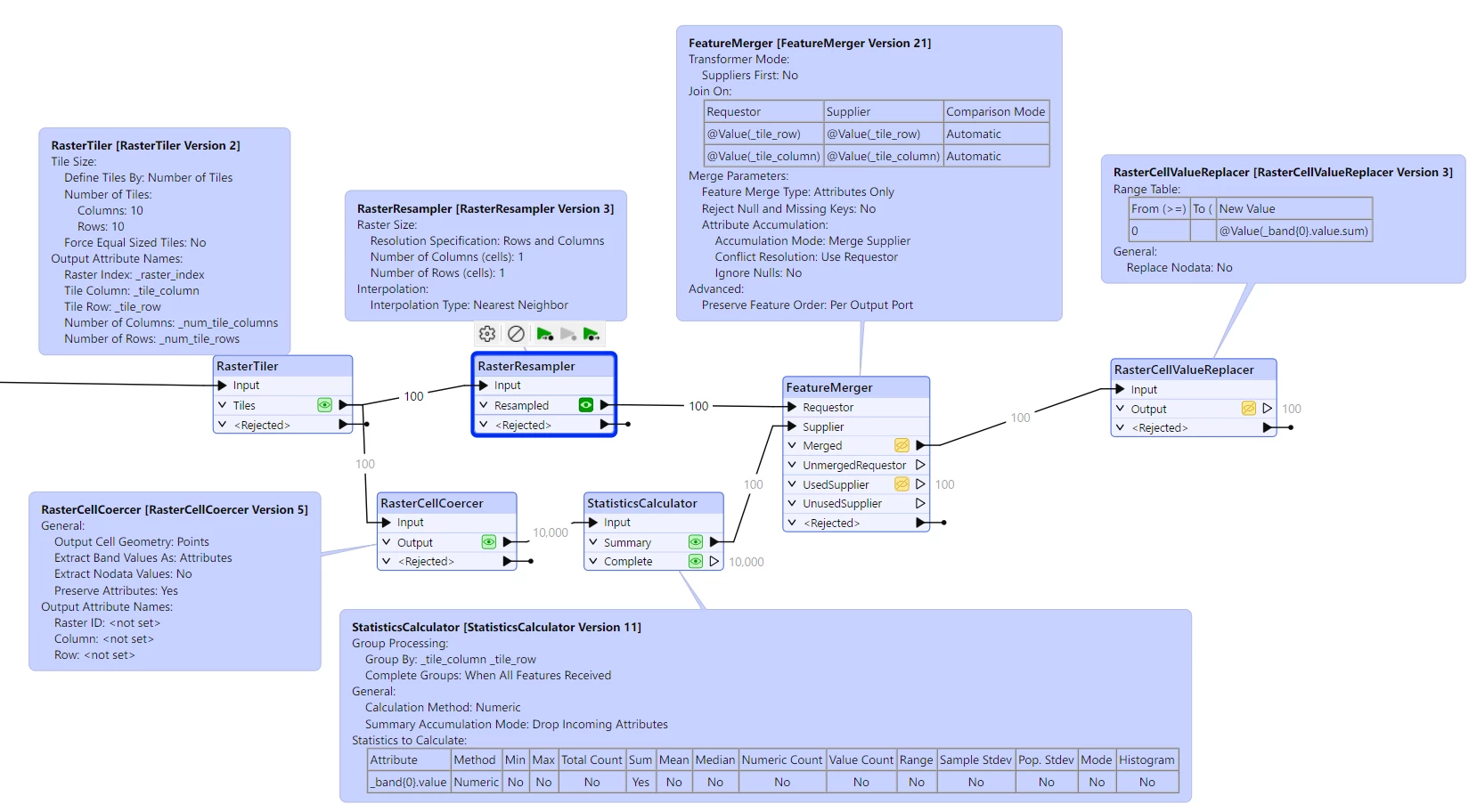

You could do something along the lines of:
  1. Tile raster to required output size (RasterTiler)
  2. Convert each cell to a point (RasterCellCoercer)
  3. Sum the value(s) of each point in each tile (StatisticsCalculator)
  4. Resample the tiles to be one pixel (RasterResampler)
  5. Merge the sum back onto the tile (FeatureMerger)
  6. Then replace the cell value using the RasterCellValueReplacer
This is probably only suitable for smaller rasters, as the number of features you will start dealing with will get pretty massive!
There are probably some other ways, but nothing that jumps to my mind currently
