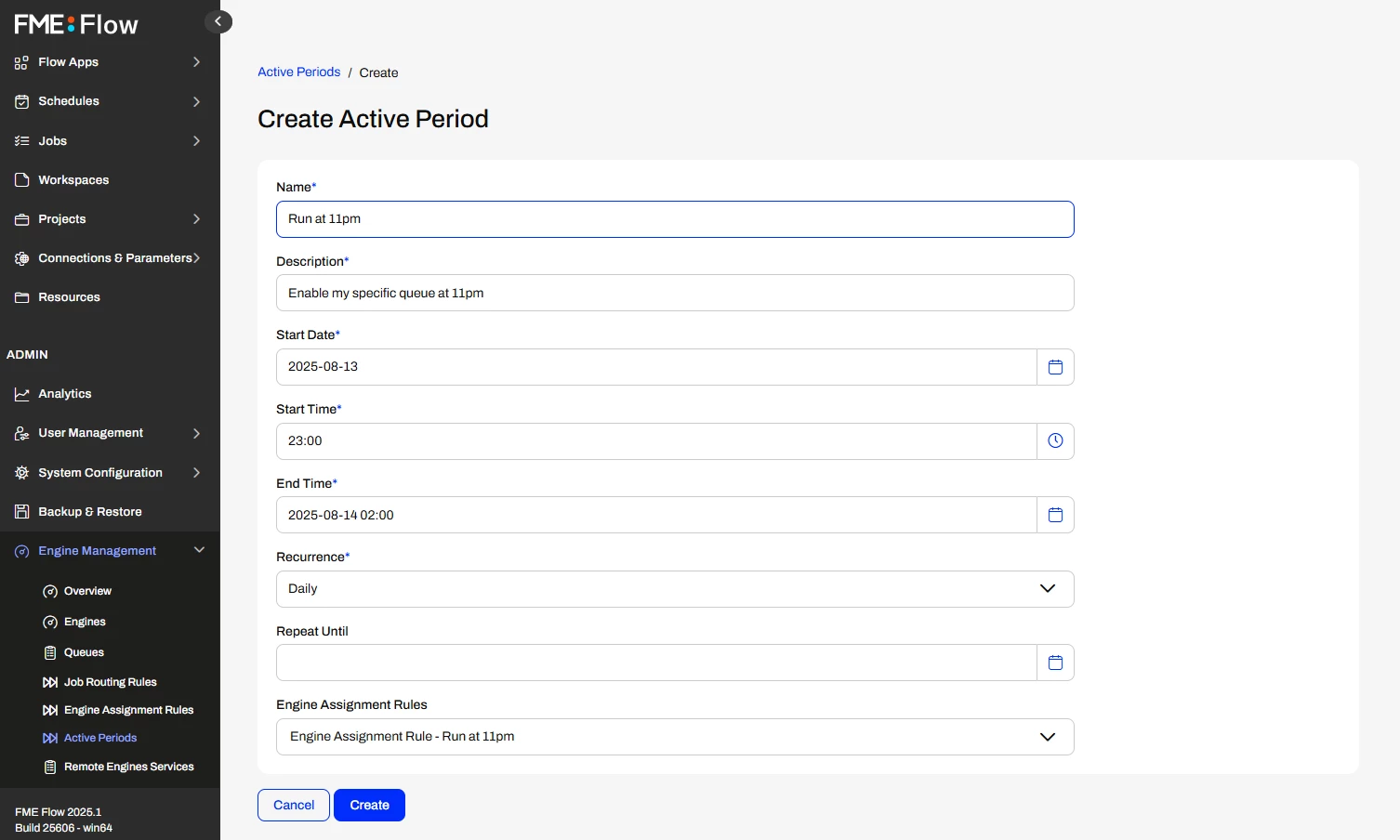

alexbiz
Forum|alt.badge.img+35
  • Aug 13, 2025 5:30 PM UTC
Why not using the Engine assignment rules active period ?
https://docs.safe.com/fme/html/FME-Flow/WebUI/Active-Periods.htm
That active period will enable a queue and run the assigned workspaces. You can then configure your workspace in your automation to be run on this specific queue.
  • Aug 13, 2025 6:39 PM UTC
​@alexbiz - interesting idea. Could start an automation with a manual trigger and then it would sit in a queue until the time needed to run. No switching on and off needed. I will experiment
