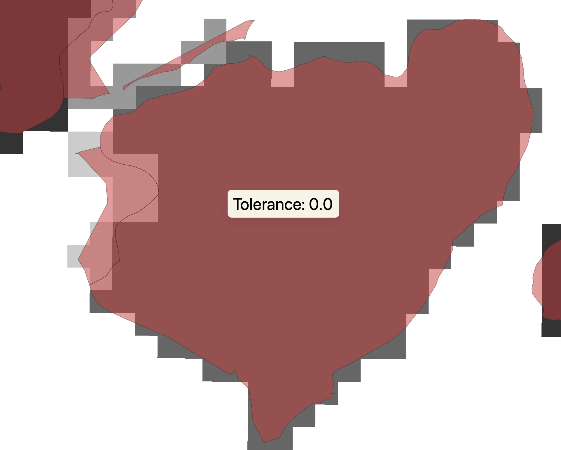

Output from NumericRasterizer with tolerance set to 0.0, with the input vector overlayed

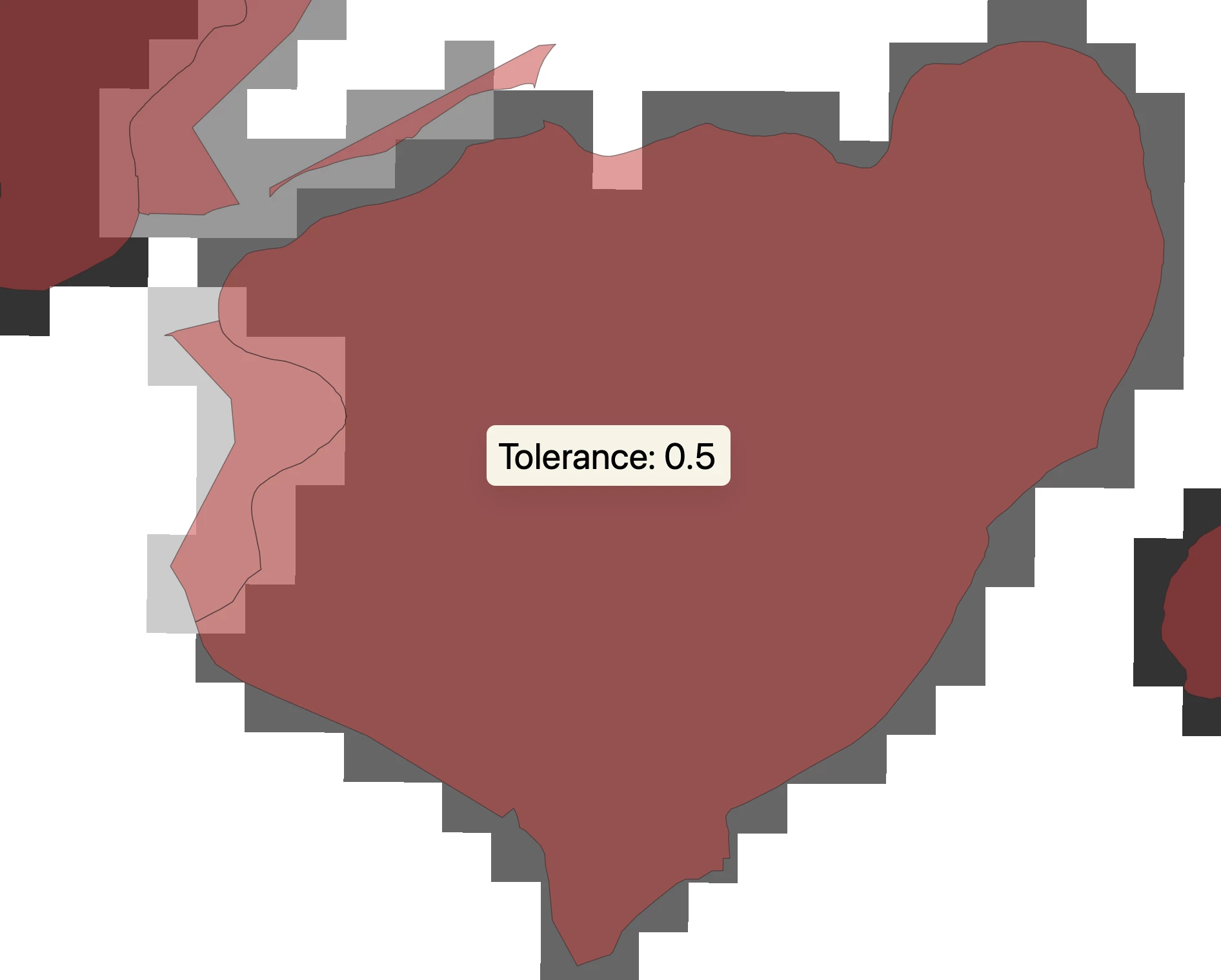

Output from NumericRasterizer with tolerance set to 0.5, with the input vector overlayed

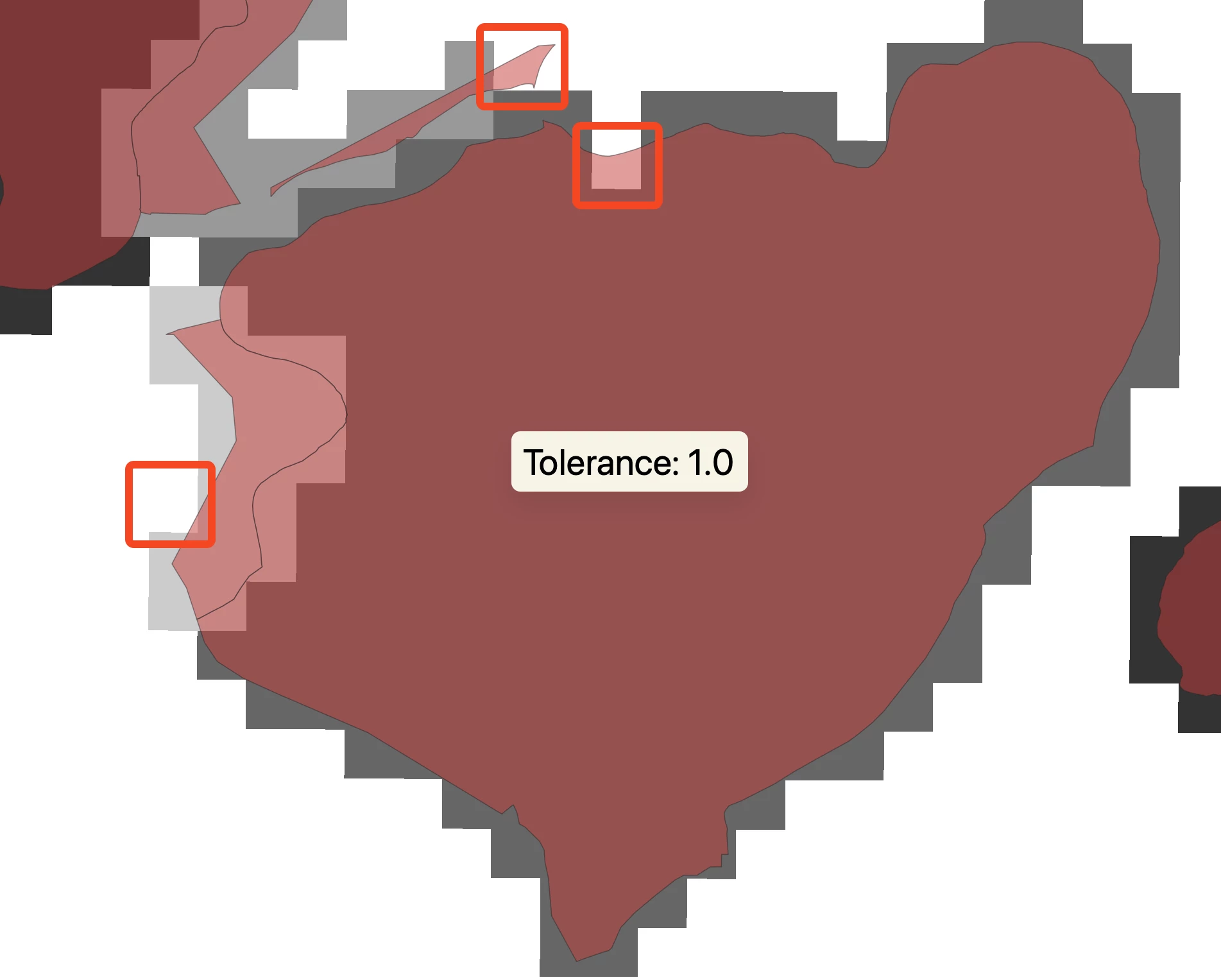

Output from NumericRasterizer with tolerance set to 1.0, with the input vector overlayed

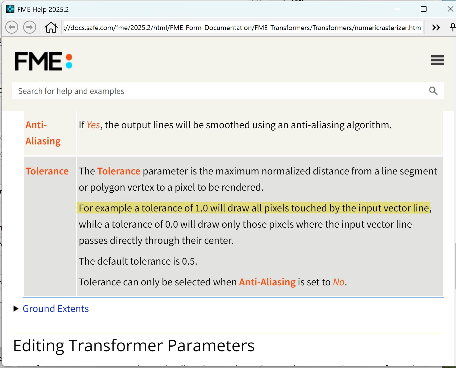

Going by the documentation, it explicitly states that a tolerance of 1.0 will draw all pixels touched by the input vector line, which can been seen above as not being seen in the output.

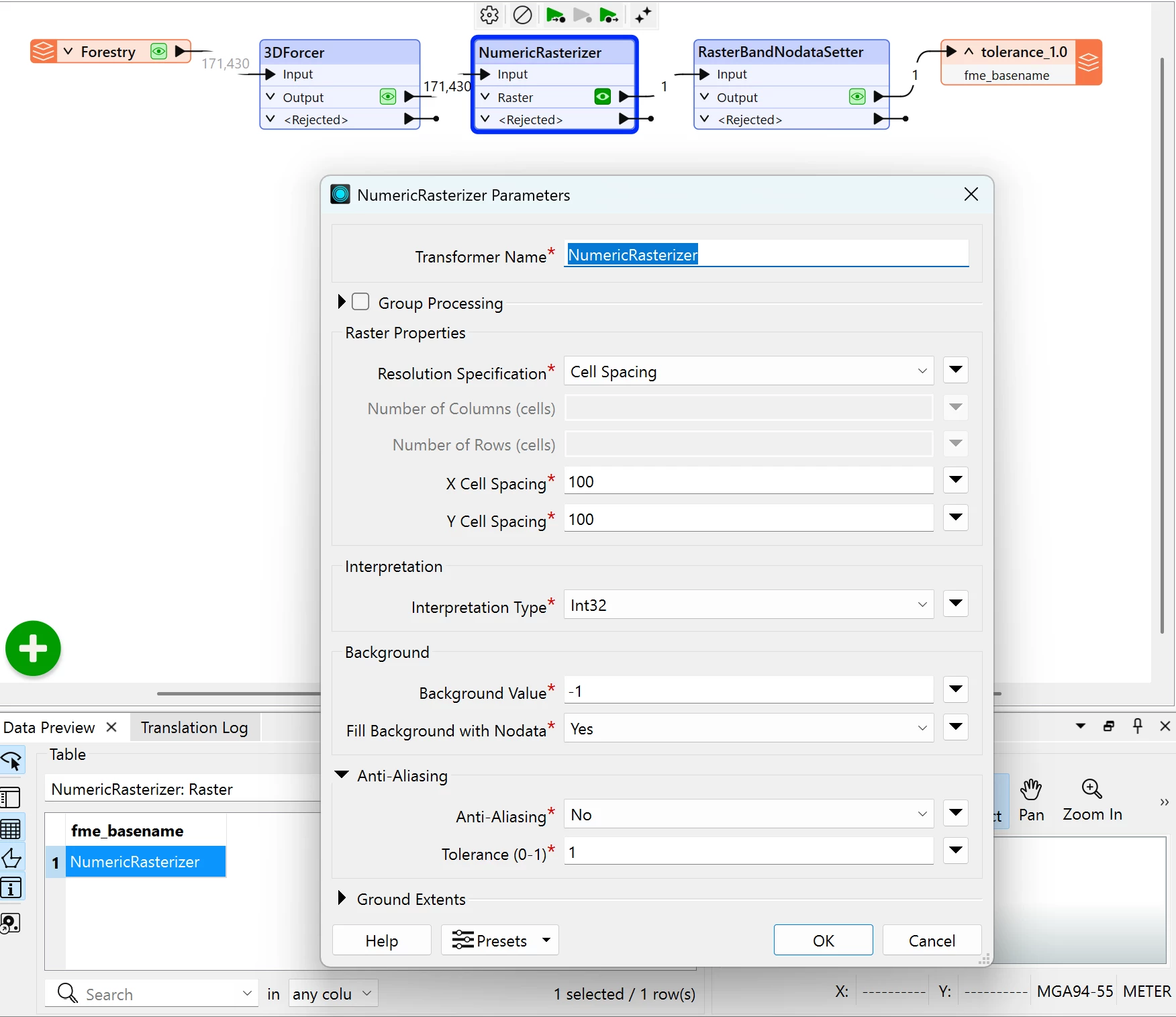

Work flow and NumericRasterizer parameters
Documentation of the tolerance parameter from the corresponding version of FME Flow
