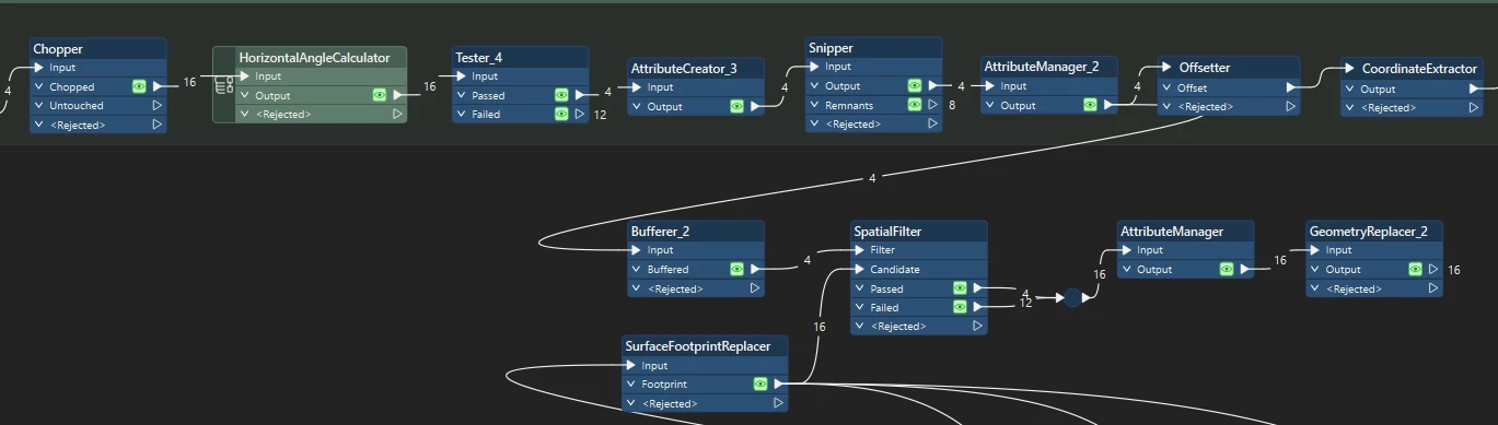

Hello everyone,
I’ve been working with 3D Buildings recently and I’d like to add some info to the walls (e.g. indicating which wall has an entrance door). I could set up this information with the 2D Footprints by using the BoundingBoxReplacer and HorizontalAngleCalculator (I’d have used it with my 3D Buildings themselves, but it only works for 2D lines). But I can’t find the right way to add this information to my 3D walls.
  • If I directly extrude the 2D walls instead of the 2D polygons, I lose the classification of Building_IDs that I want.
  • If I reconvert the 2D walls into 2D polygons with an aggregator, all my info goes away and I’m back at the starting point.
  • I tried converting the walls into points with snipping and then converting them into 3D Features with Offsetter and Bufferer such as other past suggestions, but then I hit a wall (pun unintended) becacuse SpatialRelator and SpatialFilter don’t work for 3D Data (INVALID_GEOMETRY will be written).
    • The only transformer that seems to work for 3D features is SurfaceOnSurfaceOverlyer, but my wall information is just added to the table and I can’t find how to join them with the right wall I want.
Does anyone have an idea how this could be solved? Is there already a transformer or is there something I’m not seeing?

I’ve applied your suggestions (mainly ​@takashi’s following ​@evieatsafe’s commentary about GeometryExtractor and GeometryReplacer). The idea has worked and now I can select certain walls and add differentiate the walls with a housedoor with the ones that don’t have it.
There’s only one issue: The BoundingBoxReplacer and HorizontalAngleCalculator I used to determine which walls face which direction the walls face doesn’t work as it does directly from the 2D Footprint. Virtually the same angle will be applied on two sides of the wall (instead of every side having a distinct one) I’d like to corect this because doors are facing a exact direction of the street I’m simulating. It’s probably something easy I’m not capable to see with this BBoxReplacer or HorizontalAngleCalculator.
I’ve attached a workbench with an example reader (FGDB Format). The first process is my original workflow and the second one is takashi’s workaround. Hope it helps.
javierml
Forum|alt.badge.img+3
  • Apr 7, 2025 1:18 PM UTC
Thank you ​@evieatsafe and ​@takashi for your answers.
Quick update: I was able to merge the attributes from the walls whose angles correspond to a housedoor with the new footprints thanks to SpatialFilter.
The question about how HorizontalAngleCalculator works differently still stands. It was also not possible to use PointOnAreaOverlayer because the feature type is not valid? Does this mean that, although SurfaceFootprintReplacer changes to 2D, the geometry is technically still a solid? It’s somewhat intriguing considering that, if I use GeometryCoercer to make sure feature is a polygon, all results go through untouched!

SurfaceFootprinter doesn't respect the direction of original wall surface, it's the reason why the angle calculated by HorizontalAngleCalculator wouldn't be as expected.
I think you can calculate required angle for each wall surface using normal vector calculated with PlanarityFilter. See the attached workspace example.
takashi
  • Apr 7, 2025 5:40 PM UTC
Ah, it's not necessary to use footprint, if you calculate angle with surface normals. See the attachement.

Thank you very much ​@takashi! That was a very simple but beatiful way to solve and explain it
