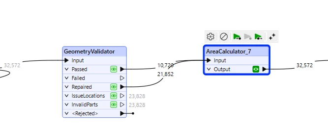

My workflow is:
GeometryValidator (Attempt Repair = Yes)       → GeoPackage Writer       → GeoPackage Reader       → GeometryValidator
Before writing:
  • Input: 32,572
  • Passed: 10,720
  • Repaired: 21,852
  • Failed: 0
After reading the GeoPackage back:
  • Input: 32,572
  • Passed: 31,789
  • Failed: 783 (Invalid Parts)
I also noticed another behaviour:
  • When Spatial Standard Compliance is included in the first GeometryValidator, the written GeoPackage appears to preserve more polygon coverage.
  • When I disable Spatial Standard Compliance, all features still pass after repair, but after writing and reading the GeoPackage back, more features fail validation.
Has anyone experienced this before?
Is this expected behaviour of GeometryValidator/GeoPackage, or should the repaired geometries remain valid after being written and read back?

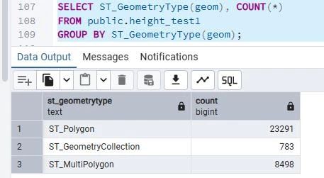

After writing to both GeoPackage and Esri File Geodatabase, I noticed that the same features were always missing. To investigate further, I wrote the data to PostGIS and checked the geometry types:
Interestingly, 783 was exactly the same number of features that were causing problems in FME.
Using a GeometryFilter (Detailed) showed those 783 features as FMEAggregate geometries.

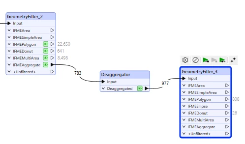

The solution was:
  1. Send the FMEAggregate output to a Deaggregator.
  2. Set:
    • Mode = Flatten All Levels
    • Split Composites = Yes
  1. Pass the deaggregated output through another GeometryFilter.

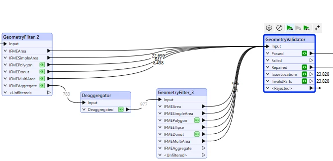

  1. Merge all area geometries (FMEPolygon, FMEMultiArea, FMEDonut, FMESimpleArea, etc.) back together.
  1. Run a final GeometryValidator before writing.
Finally, No more Geometry Collection geometries were written and GeoPackage, File Geodatabase, PostGIS and QGIS all produced matching results.
The solution was:
  2. Set:
