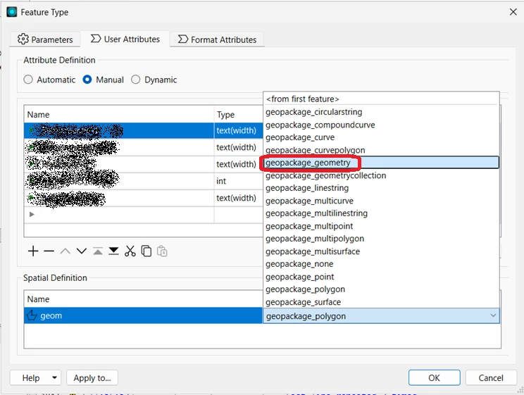

Instead of modifying my geometry, I‘ve had very good results setting the geometry type to geopackage_geometry. Essentially that allows all sorts of mixed geometry, but is really helpful when dealing with polygons and mult-polygons and aggregate polygons.
Thanks s.jager. I hadn’t noticed the spatial definition option.
Luckily I can switch to manual attribute definitions, which is requirede to change the spatial definition.
But now it at least accepts any geometry type inserted - Yay!

In the meantime, in addition to s.jager's advice to set the OGC GeoPackage writer's spatial definition to geopackage_geometry, you may also have more luck if your fme_aggregate geometry is stored as MultiArea parts (IFMEMultiArea - maps to geopackage_multipolygon) rather than Aggregate parts (IFMEAggregate - maps to geopackage_geometrycollection). You can use an AggregateFilter and GeometryFilter (detailed mode) to determine whether your aggregate features are IFMEMultiArea or IFMEAggregate.
