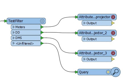

Use TestFilter and validate the input based on format/number of digits/any other criteria and then pass to respective transformer as shown in the screenshot to avoid confusion
I would also suggest to have a Terminator on the <unfiltered> with a clear Error Message that the input coordinate was not in a valid input format. And maybe a schema showing valid formats.
