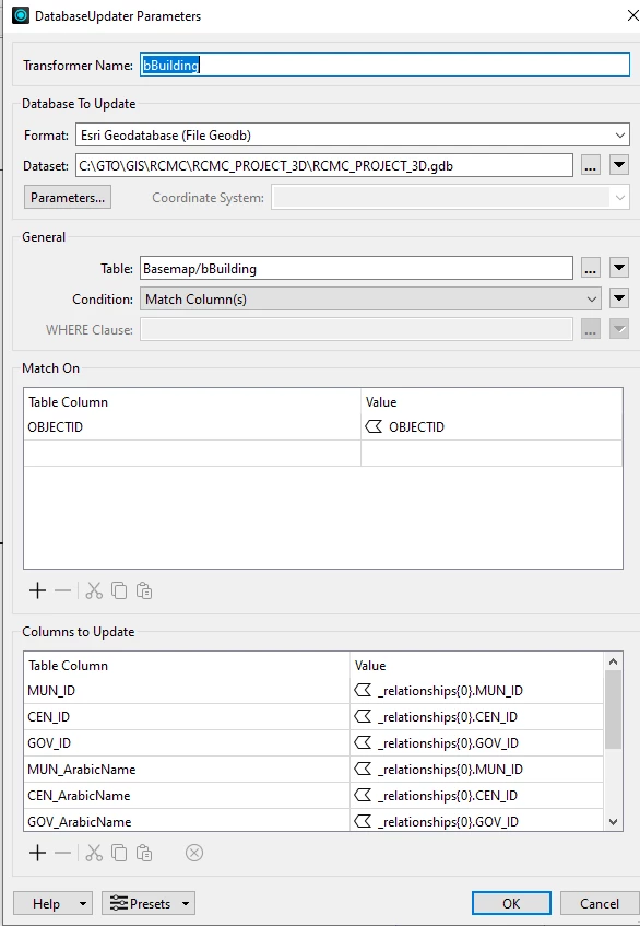

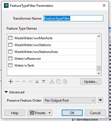

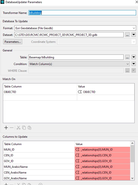

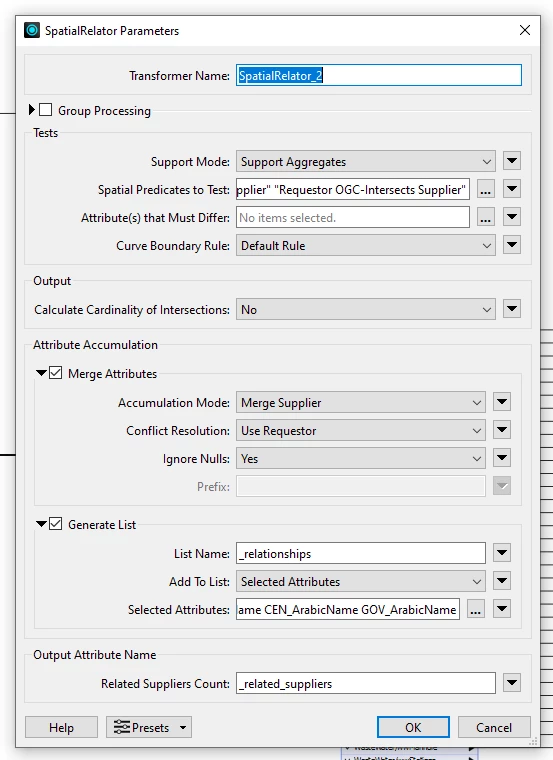

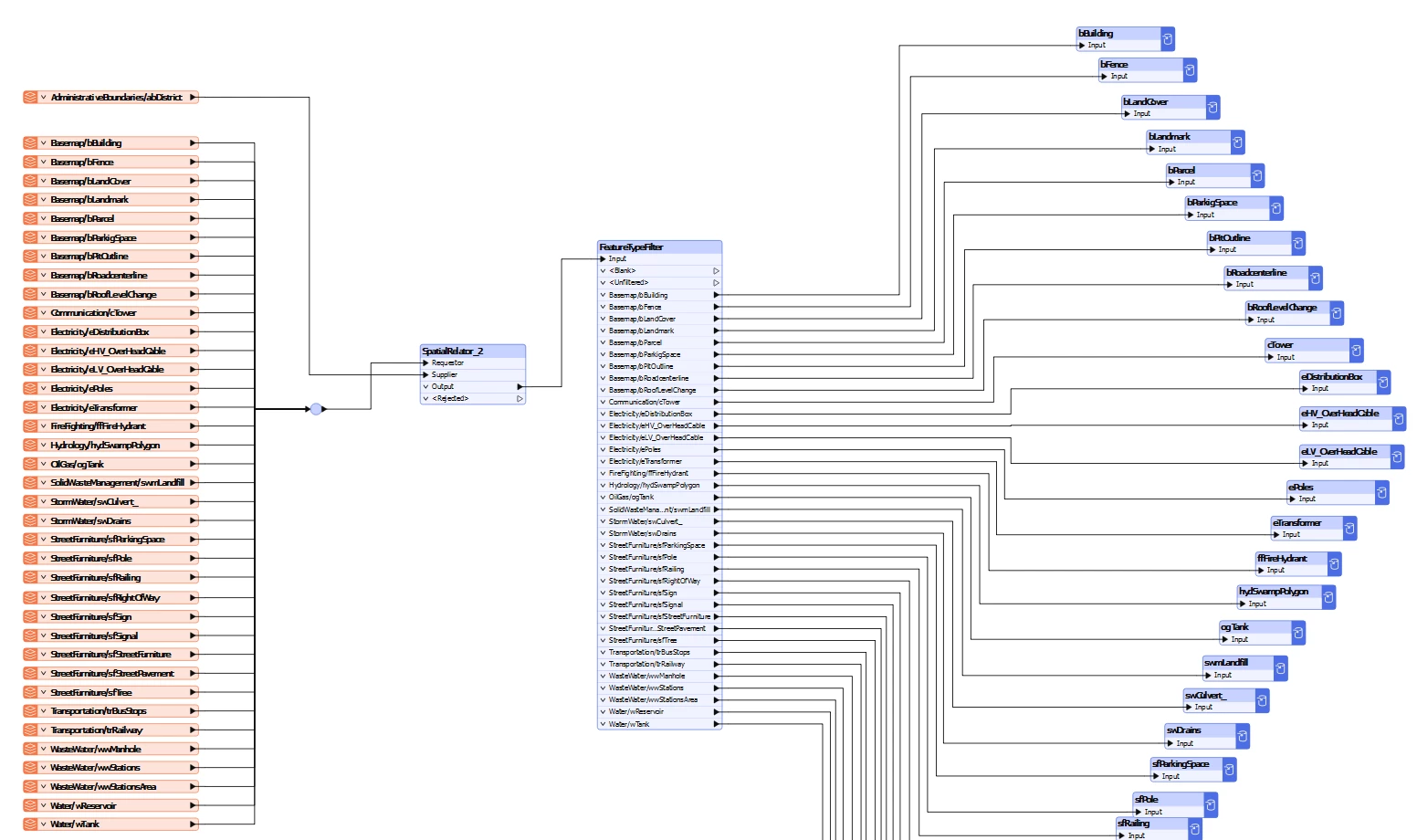

When a database is updated using SpatialRelator, FeatureTypeFilter, and DatabaseUpdater Transformers from feature classes inherited from two different readers, the _relationship attribute disappears when the FeatureTypeFilter Update button is used. All DatabaseUpdater transformers are in the "incomplete transformer" status. When examining the DatabaseUpdater transformers, the _relationship values are red. Copying and pasting the same value fixes this. To avoid this issue, you must manually edit the FeatureTypeFilter, which is time-consuming.

I can see you've already identified the current workaround which is manually typing in the feature type names instead of using the Update button. You're absolutely right that this is tedious, especially when working with multiple feature types.
