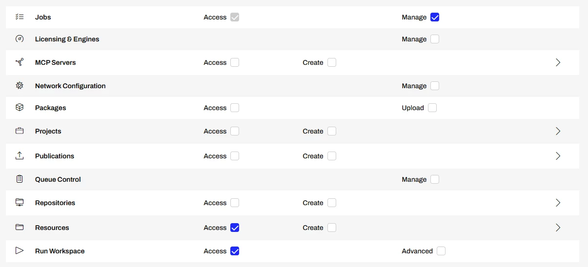

About half a year go we set up a API Token thats being used by an external Web Application which triggers jobs on our FME Flow environment. This worked all fine till we upgraded to 2026.2 this summer.
The right's we had set up were:
Jobs Access
Recources Access (only to the required resources folder)
Run Workspace Access
Since the upgrade to 2026.2 nothing was changed by us in these settings. The web application can still start jobs as needed. But any request of GET /jobs/{id} , /jobs/{id}/result en /jobs/{id}/log gives a 403 error now. The only way i found around it is to give the API Token the Jobs Manage permisson.
But this feels wrong to me. If i read the documentation this would give the token access to all users jobs instead of only the ones started through this API Token. I can't find any mention about changes concerning this (only about the Tokens for FME Flow Apps which we are not using).
Anybody has any idea what could be the cause here? Am i overlooking something?

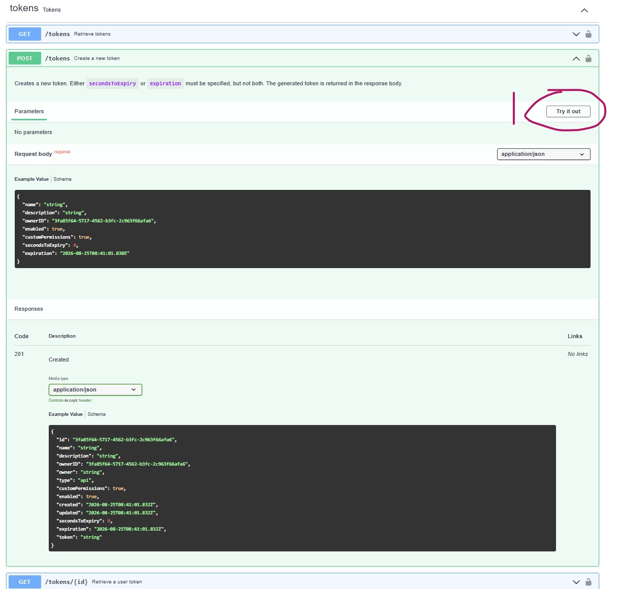

You might want to go into Flow.. top right and find the REST api document.
In the right corner, get token and sign in to get 1 hour token
This lets you use the Try it Now
NOTE. in v4 you need the JSON https://docs.safe.com/fme/html/FME_JSON_GUI/
  "name": "string",
  "description": "string",
  "ownerID": "3fa85f64-5717-4562-b3fc-2c963f66afa6",
  "enabled": true,
  "customPermissions": true,
  "secondsToExpiry": 0,
  "expiration": "2026-08-25T08:41:22.382Z"
Hit execute to ensure the JSON above you are parsing externally to the REST api is valid
Check the cURL
Response
check dependencies

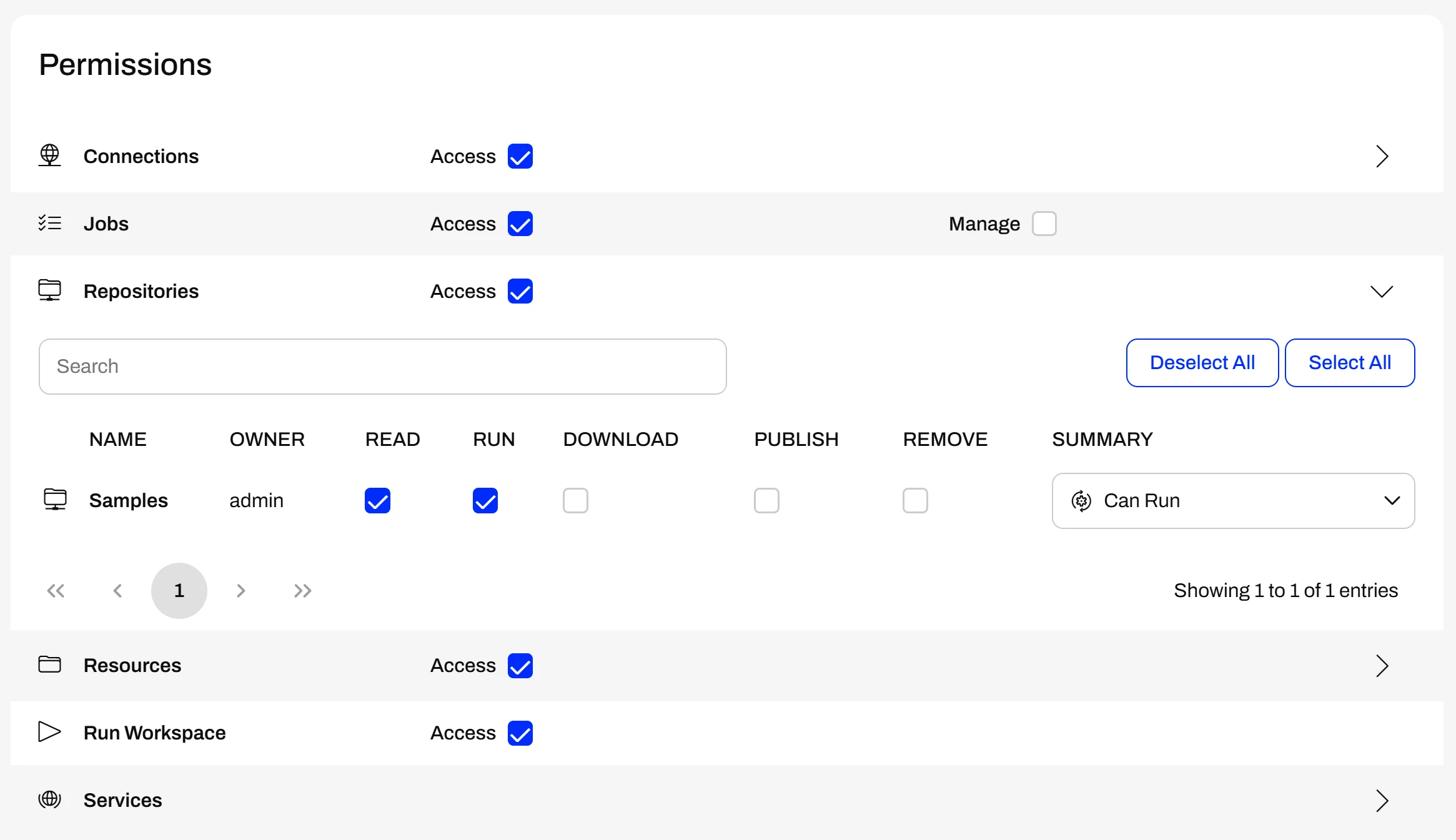

Hi ​@jeroen_hack,
Thank you for reporting this issue. I was able to reproduce this with the GET /jobs endpoints. It seems like you cannot run view jobs you own without the Manage permission. I’ve gone ahead and filed this with our development team for their review.
For your reference, the ticket number is: [FMEFLOW-29268].
I did this out using basic user authentication as well and I was able to make the GET /jobs calls without any issues.
However, I did not have any problems running the POST /fmeapiv4/jobs (to start jobs) call. In your API token permissions can you confirm that you’ve provide the individual repository RUN permissions?
