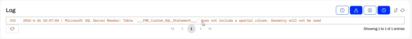

The Readers now give out more warnings than before, it’s becoming an issue for some when monitoring from FME Flow or when someone who isn’t a daily FME user needs to run a workflow.
A way to tone down those types of warning would be a great addition, because sometime the warnings are actually meaningfull and we don’t want to have look at all the jobs or remember that X numbers of warning for this specific workspace are meaningless.
Two examples are these:
  • Spatial and Non Spatial Reader/Writer got merged together, if you don’t have a spatial component it warns you about it each time, but it’s useless.

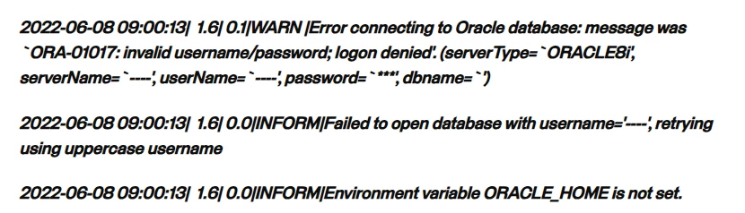

  • Oracle Reader: Username and Password in lower case cause a warning that can be interpretted as an error (copied the error from an older post)

I’m not sure why you posted this, because this is not about warnings that we can deal with ourselves. This is about warnings that are generated by FME,  which only serve to clutter my dashboards, and which I can’t do anything about. I have some workspaces that use an SQLExecutor. Since the consolidation of SQL Server database types into one, these (depending on the sql statement) generate the warning that no geometry will be read because it wasn’t found in the sql statement. Yes, I know that, and that’s fine. I do not need a warning about that, since I wrote that sql myself. What it does do, is cause a workspace to generate 63045 warnings. And it is entirely possible that warning 27843 is actually an error in the database that I need to fix - but  don’t know until I’ve looked at all of them. THAT is what this idea is about, and the threads I linked. And no amount of filtering the log is going to help that either.
