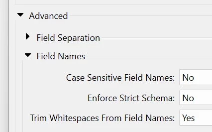

CSV readers have a case sensitivity parameter (and others as below) so it is possible for at east that type - perhaps there could be a setting for all readers in the Navigator window or reader/feature reader dialog for something like this.  Having had a data provider change case on field names in the past year for a critical dataset it would allow some insurance against that type of situation (but not against the changing of any part between start an end of string).
