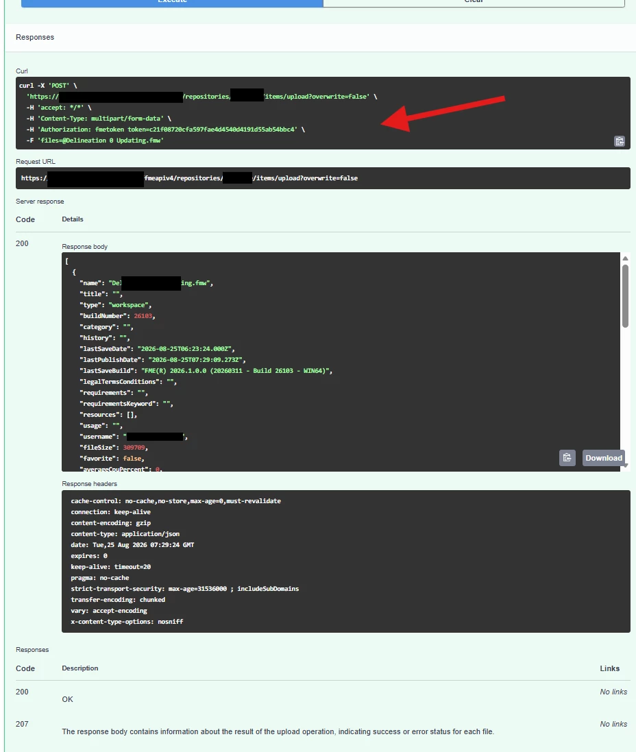

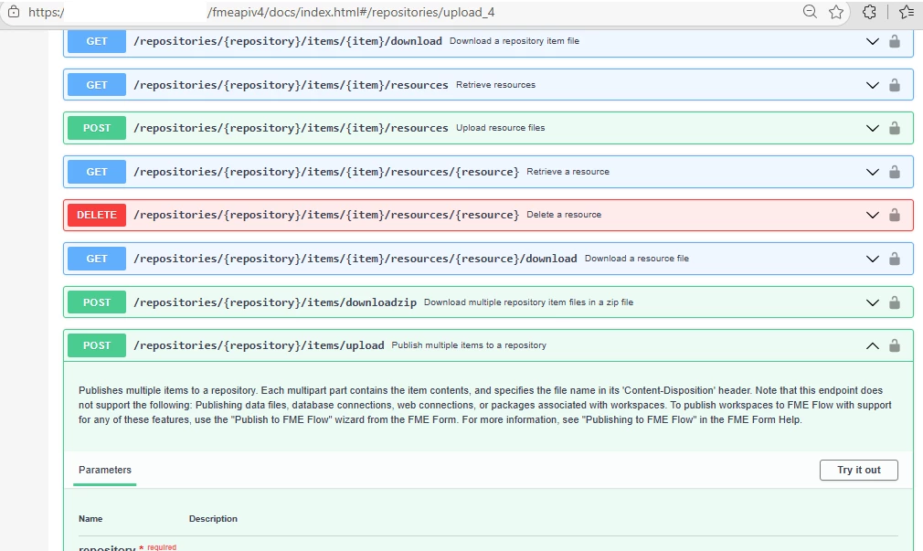

ok here is another approach, I would login to Flow and then help > REST API documentation
Optional to the right, hit Get Token and enter again your login details to get a 1 hour temp token
This will allow you to use the “Try it out” functionality
Go to endpoints and this POST /repositories/{repo}/items/upload  and hit the try it out
Fill out the parameters…
  1. entering the repository you intend to upload to
  2. then choose the file
Note. how the request body is already on the multipart/form-data
hitting execute will preview cURL, and the result - response
compare this to your httpcaller
check the repository

Awesome thanks for the help ​@j.botterill will try that out and hopefully can figure things out using that approach
