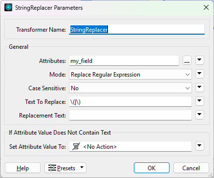

You can try this:
It will remove any paranthesis (open or close) wherever inside “my_field”.
Here’s the regex for copy-paste purposes:

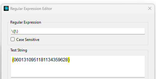

You have to escape the parantheses. This works:
Search for ( or ). Replace with nothing.
Note that this will replace every ( and ).

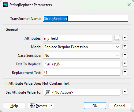

If you want to only remove parenthesis at the beginning and end of the string, and not inside the string:
