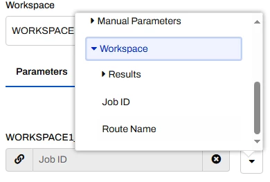

Myself I don't have any experience with the the FMEServerJobSubmitter and I was wondering if there are other ways to pass the job-id from one workspace to another workspace in an automation.  I tried using the automation writer as a method to pass a job-id from one workspace to another workspace, but that doesn't seem to work, the job-id is empty in the second workspace.
Best answer by ebygomm
If you have a parameter in the second workspace to receive job id, you can pass it the job id from the workspace by selecting job id under workspace parameters
