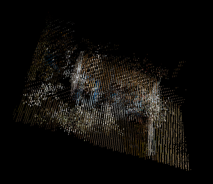

Excuse me, I am a master student. During one of my curriculum module, I used the Cesium 3D Tiles Writer in my project. And the result is not good:
As we can see, some of the lines of point cloud is missing.

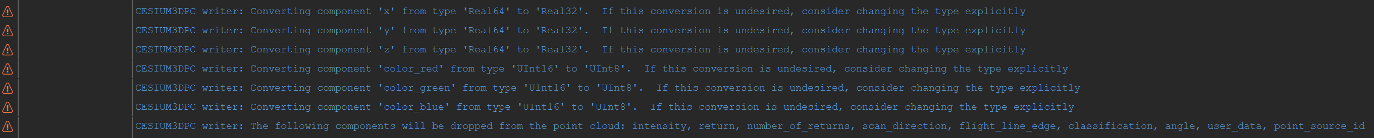

And during the procedure of translation, I ahve warnings like this:

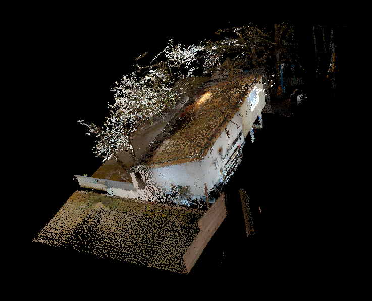

What’s more, is that the result put all points inside the same pnts file:
So when I try to visualize it on the website, it becomes stuck and process in a very low speed.

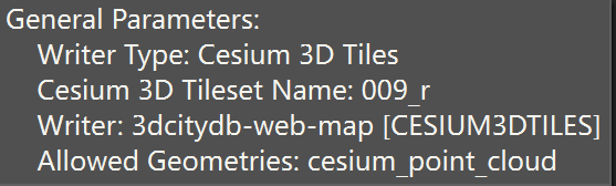

May I ask how should I manage the parameters inside the Cesium 3DTiles Writer? If anyone could help me, I will appreciate it.
