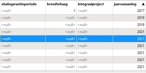

I would like to remove attributes (or columns?) from my data stream that have no value (missing or null)
In below example that means “eindegrarantieperiode” and “integraalproject” need to be removed.
Note: can we do this dynamically? I don't want to manually go through 50+ attributes to check if they contain a value or not.

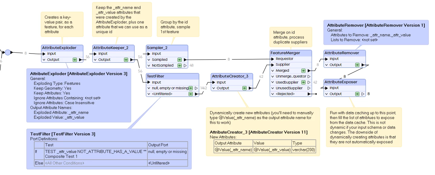

Similar approach. Basically what I do is use an AttributeExploder to create features with 2 attributes holding an original attribute name and value. Then filter those where the value is empty, null or missing, recreate the attribute and then merge it all back.
The downside of this approach is that the dynamically created attributes are not automatically exposed.
