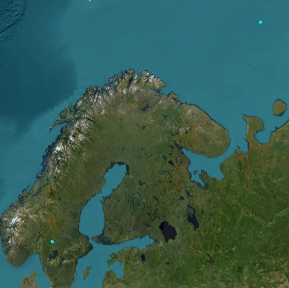

Hi, I have a very simple FME worskspace that reads a shp-file and via Esri ArcGIS Feature Service updates a Feature Layer (hosted) on Portal for ArcGIS.
The data is simple plygons with a few attribute. The  Feature Layer is published from the same data in ArcGIS Pro.
When i run my FME script the polygon ends up aprox 2000 km wrong. It does not matter if I have Feature Type Handling: Use existing or Truncate.
If i use the old Esri ArcGIS Portal Feature Service writer it works fine.
I am using FME 2025.1, Portal for ArcGIS 11.4 and PCS is EPSG:3006
