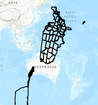

Thanks for all the info! I’ll submit a ticket. I did set True Curves to No, and the data wrote without errors, but the result is very wrong (see below). When writing the same exact data with the old ArcGIS Online writer, everything shows up in the right place with no errors.

I’m having similar issues (data loads fine to AGOL content when using the old connector, but rotates and moves off the coast of Australia when using the new new ArcGISconnector. I’m assuming it’s a projection issue, but have had no luck fixing it. Were you able to solve this issue? Thanks!
No workarounds yet, but I do have a ticket open with Safe Support regarding the issue.

Hi FME Community,
For anyone experiencing issues with data being written to the wrong location, this behavior seems to be related to coordinate system differences between reference-registered data and the Feature Service’s spatial reference.
The Target WKID parameter on the writer determines the output coordinate system. The writer should automatically respect the existing Feature Service’s spatial reference during inserts and updates, but it is not doing so at this time.
To ensure your data is placed correctly, please check the feature service metadata (e.g., /FeatureServer?f=json) to identify the coordinate system used by the service, and enter that WKID value in the writer’s Target WKID parameter.
Our team is aware of this issue and is working on improving this behavior (tracked internally as FMEENGINE-88607). The expected behavior is that the Feature Service Writer automatically detects and applies the Feature Service’s spatial reference WKID from the service metadata when inserting to an existing Feature Service.
We apologize for the inconvenience, and thank you for your patience in the meantime!
