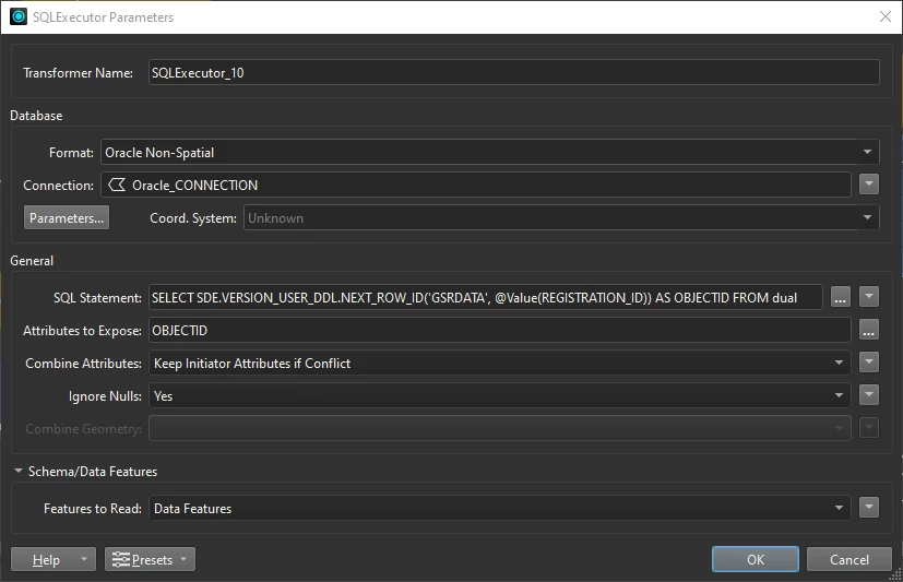

Just stumbled over the same issue in FME 2024.2. In my case none of the above mentioned reasons triggered this behaviour.
In fact the SQLExecutor (inside a Custom Transformer) caused the flaw by removing the unexposed attributes “fme_geometry” and “fme_type”. Changing Oracle Non_spatial to Oracle Spatial_object had no effect. My Input line feature lost both fme attributes.
As a work around I used a geometry_extractor bevore and geometry_replacer after the SQLExecutor.
Has anyone an explanation why both attributes are consumed by the SQLExecutor? In my point of view I’d cleary classify this a a bug!
SQLExecutor parameter settings
