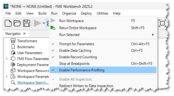

Just sharing information about a new feature I found.
"Enable Performance Profiling" would be introduced in FME 2025.2 Workbench. You will be able to log detailed performance profiling on workspace run easily whithout editing header.
Have been waiting for 10+ years :-)
Sharing: Detailed Profiling of Workspace Running Performance
[Addition] The command is available since FME 2025.1. I have overlooked that...

TIL there’s a performance profiler, thanks for sharing!
I’m wondering whether this setting is tied to Workbench itself or to the individual workspace. Could we also have this kind of parameter available on FME Flow? That would be really interesting for generating analysis reports directly from the CSV outputs on Flow.

Isn’t it the old one, just easier access? Any info on that?

Yeah - it looks like they’ve gotten rid of the option to edit the header - I guess it forced them to add the option directly into the settings. To me the output csv looks the same.
From memory it’s not supported on FME Server - it also itself has an impact on performance.

​@itsmatt I will share that I have recently used this with FME Flow 2025.0/1.
To match output with Form you’ll need to disable feature caching and feature counting as these do not come into play on Flow.
