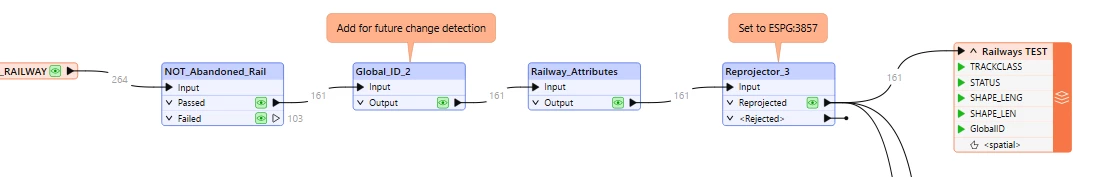

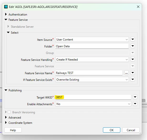

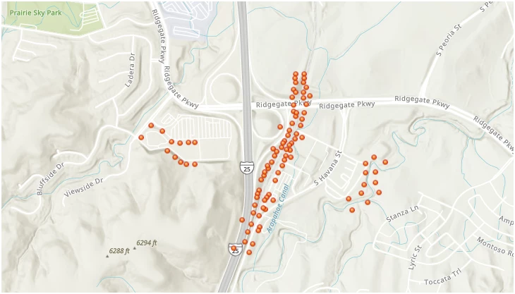

I’m publishing hosted layers to ArcGIS Online (AGOL) using the Esri ArcGIS Feature Service writer. My issue is that the map extent for the item in AGOL is at 0,0 (aka middle of the ocean). I’m not sure what I’m doing wrong to cause this problem. I have attached screenshots below of my workflow and writer settings.
I reproject the layer to ESPG:3857 as recommended. I have also tried with ESPG:102100 and no luck.
Workflow to publish to AGOL
Write parameters in Workbench 2025.2

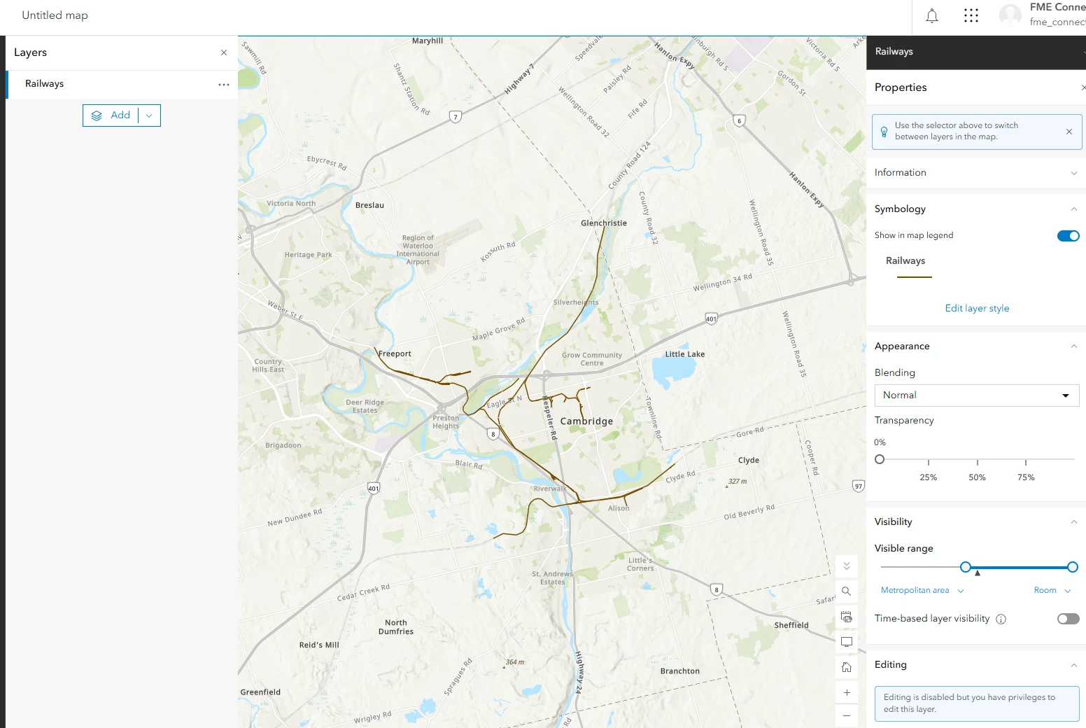

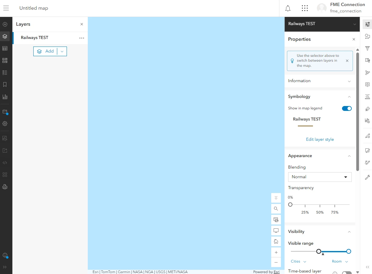

The current map extent in AGOL:
My goal map extent that is zoomed into the layer:

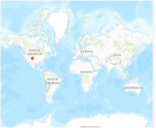

Documentation states that you can change Target WKID to a local CRS, changing it to local will not change the initial extent of your data, keep your TargetWKID to 102100 or 4326 whichever unit is applicable to your data:
  • 102100 → ±20037508 / ±20048966 (meters)
  • 4326 → -180, -90, 180, 90 (degrees)
I have a very similar workflow as yours and I actually repro’d your extent in Null island when I changed my TargetWKID to 2232 (Colorado Central). In my case, the data is still in Colorado but the default extent is null island. Its a weird behavior the data is projected but the initial extent is scaled to null island ….. after more tweaks, I concluded that using Coord Ref System configuration will not solve the extent.

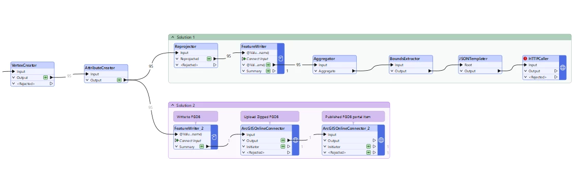

So I went back to the original problem that I wanted to solve. I got two solutions neither one I really want to pursue but it works for now.
ORIGINAL PROBLEM: Correct location with the world boundary as my extent
Solution1: Use the ESRI ArcGIS feature service writer and accept the default results of using Web Mercator, picture above. Then apply either options of the workaround below.
option 1: fix in the Settings of the feature service UI of AGOL. Solution provided by ​@hkingsbury.
option 2: Use a FeatureWriter for your AGOL Feature Writer, add an AGGREGATOR, BOUNDSEXTRACTOR and JSONTEMPLATER to build {"extent":{"xmin":…,"ymin":…,"xmax":…,"ymax":…,"spatialReference":{"wkid":…}}} add an HTTPCaller on the UpdateDefinition endpoint of the feature service to change its Full extent value.
This will change the Full extent property of the feature service.
Solution 2: Use the ARCGISONLINE Connector transformer writing my output first to a file GDB. The FGDB creation will create the feature class with the initial extent from the min XY max XY of the data.
Solution2 is my choice and a much shorter, repeatable solution without hardcoding atribute values but then I have to consider the nuances of having a feature service published from a online FGDB. You can use the FGDB for your update feature service workflow or unlink them.
Below is a screenshot of my two solutions on the canvas.
I hope there’s a better and shorter solution that others may have, but I did resolve my issue.

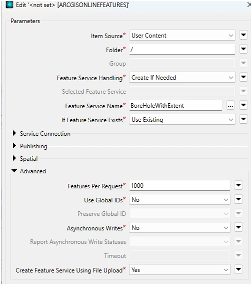

I found an easier solution… but unfortunately you have to revert back to the legacy format writers….I used the ARCGISOnline Feature Service format writer.
Set the Create Feature Service Using File Upload to Yes. It deleted the zipped FGDB after the service has been published.
I submitted this idea to add the setting to the current format writer.
