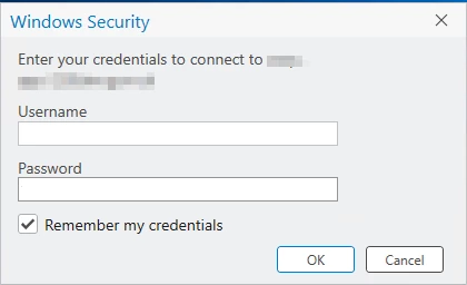

One odd thing I think it is worth mentioning is that on both servers (2019 and 2022) where FME and Pro were installed, when Pro runs this security dialogue box is displayed:
To launch Pro I enter (or after the first time confirm) the user details. I’m not sure why this dialogue shows, it has always caused me some concern.

The Windows Security dialog is a posible indicator that your SAML authentication may not be configured properly with your Windows Server OS.
I recommend to check with ESRI Support on why you are getting this extra login dialog.

I’ll raise a ticket with ESRI regarding the security issue and see if they can advise. Will also try to connect to our new Enterprise installation using the Pro installed on the FME box as well. At 11.5 the licencing occurs wholly in Enterprise, not partly with the licence manager as in 10.7.1, so maybe that makes a difference.
