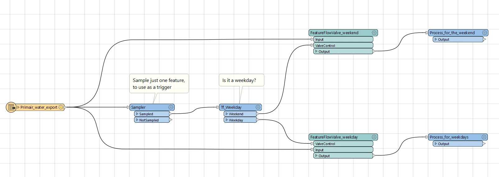

There are situations when I want a variable or parameter to determine whether a certain process is run or not. I could add the variable as an attribute to each feature and then test for the value of the variable. But that way the variable controls the process for each feature, when I already know that I don't want put any of the features through the process. And it feels like creating an unneccesary amount of extra data (even though temporarily), which I have to remove later on.
I've come across this before, and now I have a case where I want to run part of my workspace once a week and another part every day. (An alternative is to distribute the processes across separate workspaces, of course.)
What I'm thinking of is functionality like the feature reader has: it only reads features when triggered by an initiator. But I can't think of a way to do this with other transformers.

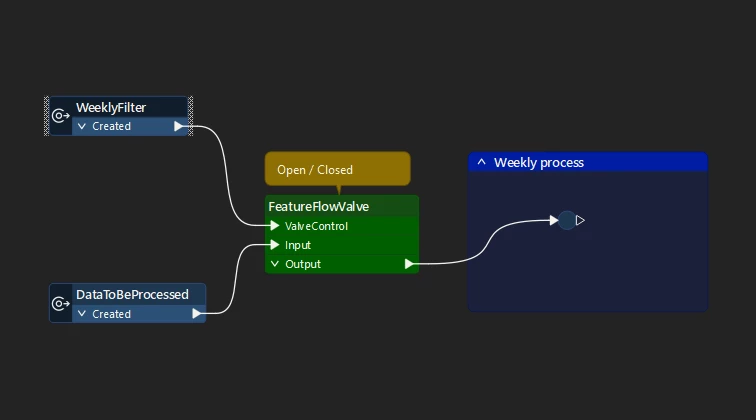

Yes, you can test on user parameter values in a TestFilter just as easily as attribute values.
And for the example you mention, running part of the process on a certain day of the week only, you can make use of the DateTime functions in a TestFilter:
So what that does is it takes a timestamp (DateTimeNow) and formats that as %u, which is the day of week (monday being 1). Alternatively, %a or %A will give you abbreviated or full weekday names, which may be better from a documentation point of view.

And the FeatureFlowValve is exactly what I was looking for! The only objection I have is that it seems to be a transformer from the 32-bit era, so a bit outdated. In the example provided by ​@redgeographics, my question is how to use the output of the testfilter as a trigger for starting a subprocess within the workspace (or not).
As I mentioned in my opening post, the only way I can think of running either process is using a feature reader, because that transformer has an initiator-input:
In my case, features have already been read previously, and they are needed in all processes. In more detail:
  • During the week I want to see if there are any changes in features, that need attention;
  • During the weekend I want to give an overview of all features that still need attention
And there could be processes that run everyday, too. It looks like this, generically:

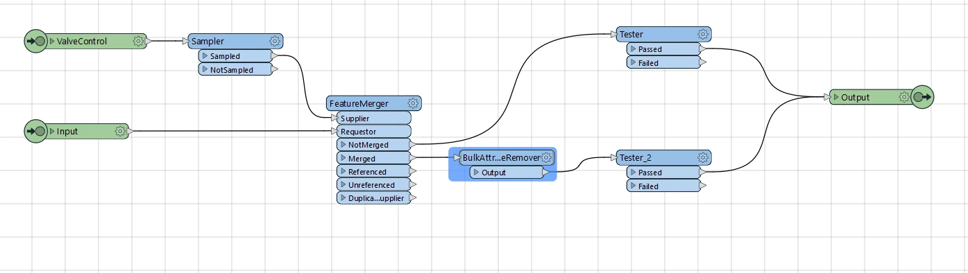

If you Embed the FeatureFlowValve (right mouse click → Embed), you can then right mouse click again and edit it, and update the Transformers if you want. It’ll also allow you to see how it works, and it is (like Matt says) basically a FeatureMerger - so you could implement this yourself as well with a FeatureMerger.

Yes. If you Embed the FeatureFlowValve, you can then Edit it, as I explained above. When editing it, you can then upgrade all the Transformers that are inside the Custom Transformer to your current version (a right-click on the Transformer, then at the bottom there’s an Upgrade-option).
If you do not want to do so, you can still Embed and Edit it, and see how it works, then implement that workflow yourself.
Using the FeatureMerger would certainly work. But, as I mentioned in my opening post, I would be adding the same value to each feature as an attribute. I'm looking for a more elegant option, like the FeatureFlowValve.
The FeatureFlowValve IS using a FeatureMerger, as Matt already mentions. It is also using a BulkAttributeRemover, so it looks like no attributes were added to each feature when they come out the Custom Transformer.

Ah! Now I see, thanks ​@s.jager . So it ends up being this:
The inside of a FeatureFlowValve

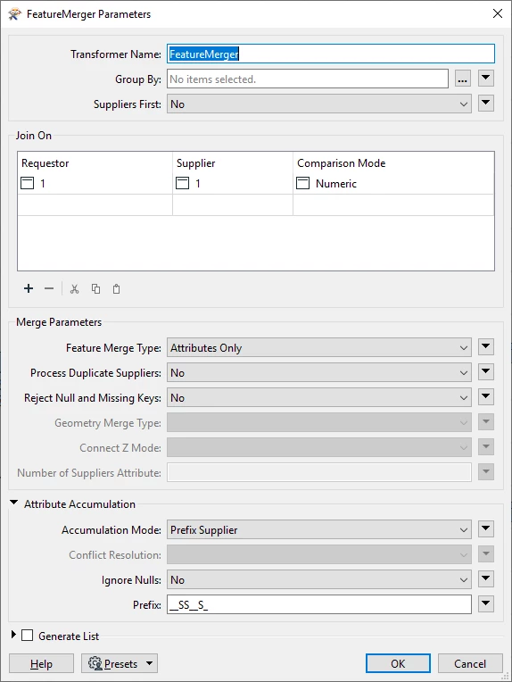

The trick used in the FeatureMerger is this:
Nothing specific is used for the merge, and any merged attributes are removed based on the prefix.
It works, but I find it unsatisfactory to join the same value to all features and then drop them again, to prevent all features from being processed when that was the goal to start with.
But for now there seems no other way.

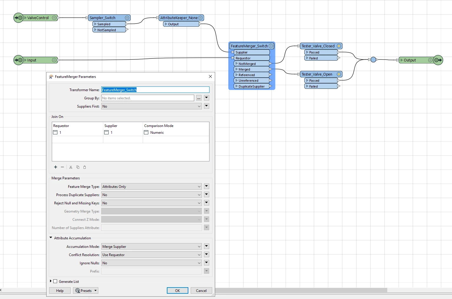

Dissatisfaction is a great motivator for change, and the weekend a great opportunity for getting ideas 😊!
I wondered whether it is possible to use the feature merger without merging any attributes at all, and it is:
I did the following:
  • add an AttributeKeeper that keeps no attributes from the incoming valve-control features
  • change the FeatureMerger settings to merge all attributes (which means: none)
  • remove the BulkAttributeRemover, since no attributes are added
It still processes all input features individually, but no longer dummy data is added and removed.
I suspect this could improve the performance of workspaces that handle large numbers of features, in  reducing the amount of writing and reading from either memory or disk.
What do you think?
