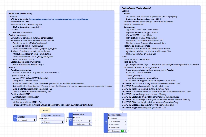

I’m trying to read a shapefile that is stored inside a ZIP file which itself is embedded inside another ZIP. I want FME to read it directly from the download URL
I tried with https://url/data.zip[shp.zip] but did’nt work.
any idea if its possible?
Thanks

​@hkingsbury Thanks for your answer,
Im trying with TempPathnameCreator and HTTPCaller but it doesn’t work.
Im getting error: Shapefile reader: Failed to open file 'C:Temp\wbrun_1761808013615_1120\ fmetmp_f\1761812991049_7960_d\tor370\http_download_1761812991267_7960.bin\shp.zip' failed to open for reading. Please ensure that the file exists and that you have sufficient privileges to read it.
https://data.geo.admin.ch/ch.swisstopo.geologie-geotope/data.zip that’s the link to download

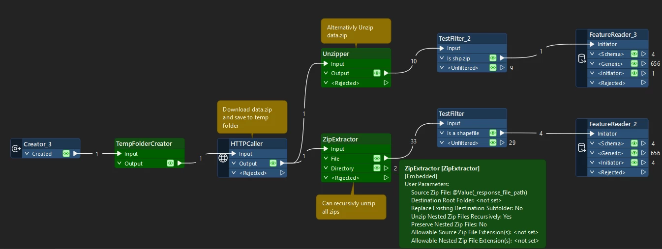

This was what I came up with - need to download the dataset and then upzip it. The ZipExtractor uses Python and can recursively unzip all zips. This is pretty nice, as you can see it’s extracted 4 shapefiles.
The Unzipper is just a FeatureReader really which will unzip the top level zip. Then you can read the shp.zip with the shapefile reader.
In the end both options work fine, The Unzipper only works for cases where the zip is one level deep but the ZipExtractor will get all file regardless of depth. This might be nice but also if you have zips you don’t want to extract then this is not ideal.

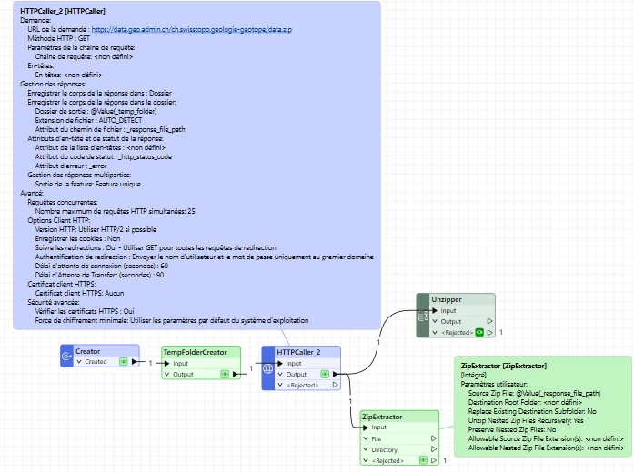

​@virtualcitymatt Thans for answer,
both of zip extractor failed. Zip extractor error: Specified zip file or destination root folder is invalid.
Unzipper: Path Reader : Erreur lors de l'ouverture du PATH Reader sur le dossier 'C:\Users\sdt98\AppData\Local\Temp\wbrun_1761808013615_1120\fmetmp_25\1761820456082_6984_d\tor330\http_download_1761820457258_6984.bin\**'. Impossible to find folder
Maybe the temp location isn’t correctly setting?

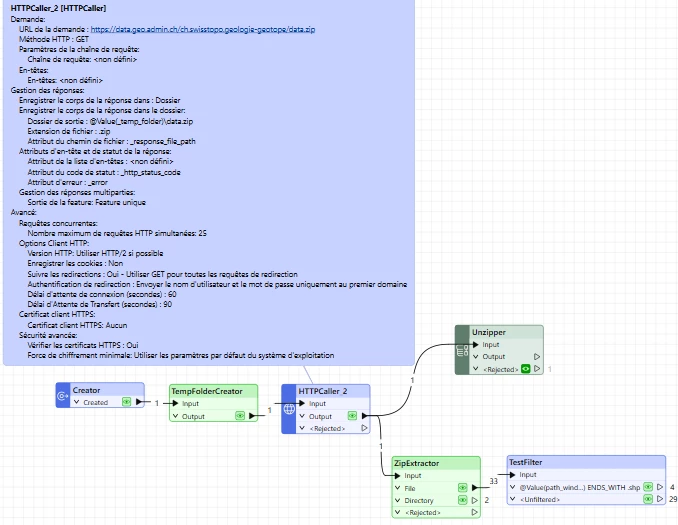

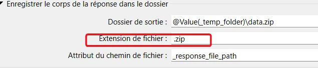

ahh sorry I’ve actaully deleted it - but I think I see where the issue is - It looks like in your httpCaller you are speficyling the downlaoded file path to be @Value(_temp_folder) but it should be @Value(_temp_folder)\data.zip
That was something I missed off from my explanation - sorry about that.
In the HttpCaller i put extension as zip file and added @Value(_temp_folder)\data.zip and works for zip extractor, but not for Unzipper
