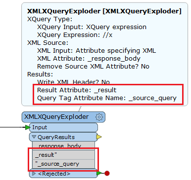

Just report a small (but annoying) issue. I noticed that the XMLXQueryExploder on the Canvas exposes incorrect attribute names, which contain a leading or trailing " (double quotation). See the screenshot below.
FME 2018.1, FME 2019.0 beta b19092

Hi @takashi,
Thanks for bringing this issue up! I have created a bug report (PR: FMEENGINE-56312), and I will post back to this thread when the issue has been addressed.

Hi @JovitaAtSafe, thanks for filing the PR.
