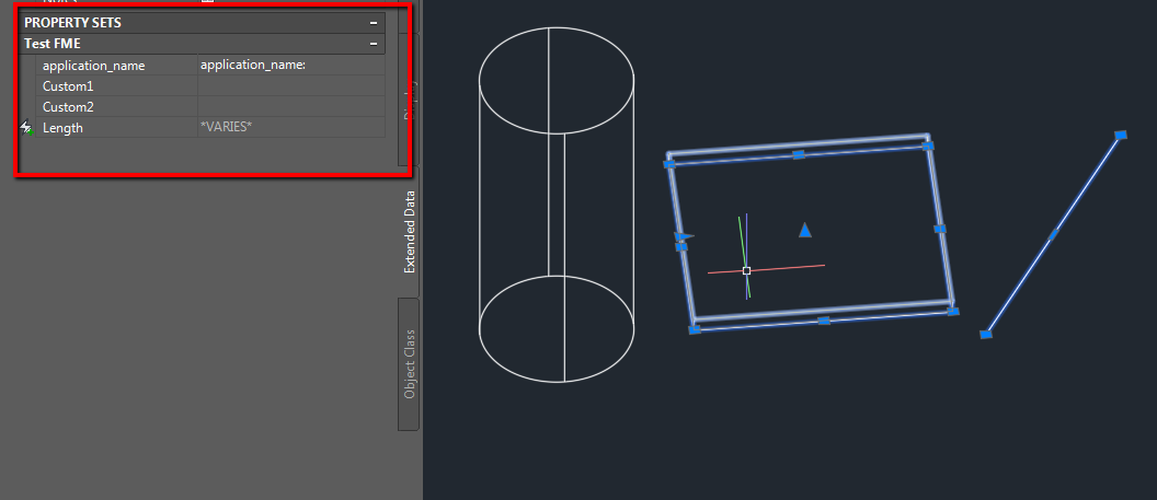

Hi,
I would like to fill those Property Sets / Extended Data fields and write it to dwg.
I can fill the values, but I can't write it to dwg including those fields.
Who can help me? :-)
Thanks!

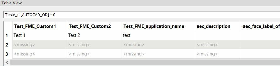

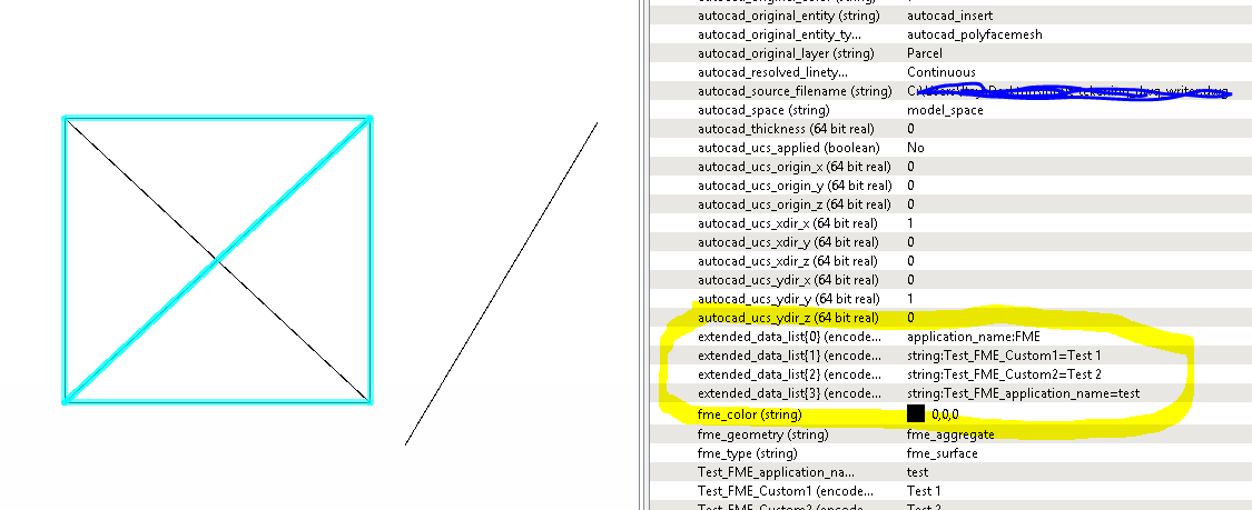

Hoi @sprongandre,
First of all nice profile picture :)
Secondly I have had a look at your workspace and tried it myself.
The extended data is written to the output as expected, see the screenshot below.
BTW you dont have the add the default application name to the template, you can edit that value in the advanced writer parameters. I have used FME as the value for the parameter.
