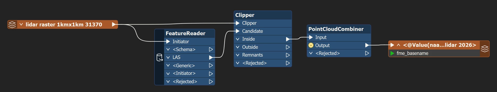

I want to tile LiDAR data. My project contains about 550 tiles (1 km × 1 km), so processing everything at once in a standard FME workspace is not practical, as my PC would struggle with the memory requirements.
At the moment, I use a shapefile that contains a "to_run" attribute. In QGIS, I select a group of tiles and update this attribute. In FME, I use a Tester together with a Feature Reader so that only the selected tiles are processed.

I feed the workspacerunner the shapefile with tiles but then in the bench that needs to run I also load in the shapefile to do the actual clipping? How does the runner know which tile it needs to use to clip?
Is something like this ok for the workspace to run? Feature reader has just the lidar dataset location and the spatial filter on intersect. Clipper only merge attributes and the combiner has a group by on “name” (an attribute from the shapefile).
In the workspacerunner I also need to give the source las data… Is it the same as in the featurereader or should I not work with a featurereader?

Adding another featureReader that uses Directory and File Pathnames format, where you utilise the path_windows going into the FeatureReader you have for LAS file. Then you’ll need to decide how to reorganise the workspace to accomodation a parent/child orchestration. It seems to me, you might need user parameters in the existing workspace as the child. Then the parent workspace does the path reading
