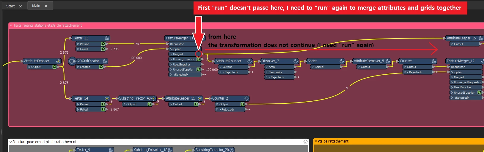

WORKFLOW PROBLEM: I have to run the workflow more than once to be able to perform the transformation correctly.
  • Jan 1, 2021 6:58 PM UTC
  • 37 views
giuseppecfgeo
Forum|alt.badge.img+5
How can I correct the timing of the data flow in this case? In the first "run" the data stream does not pass through the FeatureMerger. I think the problem is the 2DGridCreator which creates 100,000 cells before the FeatureMerger and which takes a long time. In the attached image I show how the transformation is after the first "run". Which transformer should I insert? And where should I enter it? Should I use the "TimeWindower"? How?
Forum|alt.badge.img+2
@giuseppecfgeo​ Happy New Year.
Do you have Suppliers First = Yes set on the FeatureMerger? Feature caching can mess up the ordering of features. Test if this is the case by switching off feature caching. For testing, set Spppliers First = No OR put a book mark around the Grid Creator, Tester and FeatureMerger and then collapse it (feature Caching is turned off inside collapsed bookmarks.
