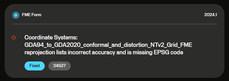

Discovered today that this issue has been resolved from 2024.1 onwards.  That is for Form - not sure if fixed in Flow as well, but I assume so.  Haven’t done any testing to check, but if anyone does in the meantime and can confirm in here that would be appreciated.
On the changelog page at Changelog - FME by Safe Software
Good to know it’s been sorted :-)
