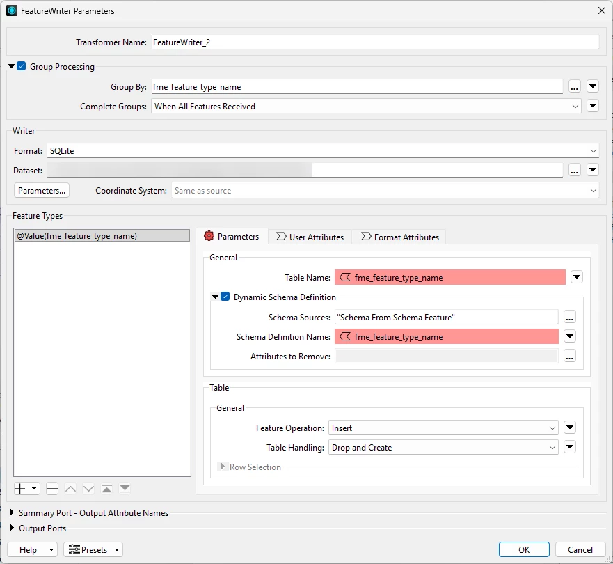

crystalwang
Forum|alt.badge.img+31
Hi ​@marie-lamb,
Thank you for posting your question on the FME Community!
Although I was writing out to a different format, I believe this configuration in the FeatureWriter could help. I connected the two output ports from the SchemaScanner (Schema and Output) to a singular input port on the FeatureWriter. Here is the setup I used:
Feel free to give this configuration a try let me know how it goes!
