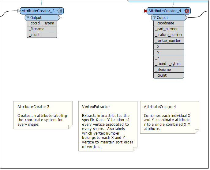

As mentioned in another post, I'm currently upgrading a bunch of workbenches to run on FME Flow 2024, some of them many years old. Typically, for anupgrade, I will go through each workbench, upgrade all transformers, readers, and writers, then run it in test desktop (workbench) environment, then publish to and test in a test server (flow) environment.
In, FME 2024 the Vertex Extractor gives me bogus results, even after upgrading all the constituent transformers in this custom transformer. It looks like X and Y, or Lat and Lon, are reversed.
When I open the CoordinateConcatenator (arrow above), I see this:
Default setting
While I haven’t dug through the rest of the custom transformer, this - frankly - looks counter-intuitive.
When I change that to “XYZ”, everything runs just fine and results are as expected.
My tweak
I have tried to compare my version (I’m assuming that upgrading all components makes it uptodate) to older versions to see whether upgrading might have introduced this problem but I see the same from the screenshot in older version of the Vertex Extractor.
Has anyone come across this? I’m using 3D data for this. Never had an issue before. But I also don’t remember that I have tried to upgrade the components inside this particular custom transformer before. So it’s possible I have carried over an ancient version through a number of upgrades. Never noticed any adverse consequences though.

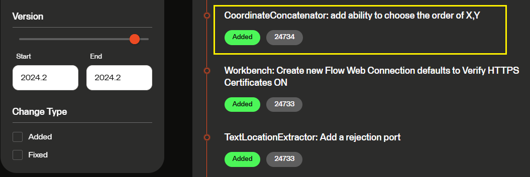

Hi ​@agelfert , there must have been a problem with the CoordinateConcatenator some time between FME 2016 and 2019 where "X Y Z" changed to "X Z Y". However, this didn't change the behavior and it continued to concatenate in "X Y Z" order - until the fix that ​@takashi noticed from build 24734.  You should only see the problem if running FME 2024.2+ and the VertexExtractor is embedded in the workspace.

It seems that the implementation of CoordinateCocnatenater has been updated in FME 2024.2 and it cause the issue, I guess.
Hope some one from Safe explain abount this. > ​@DanAtSafe ?

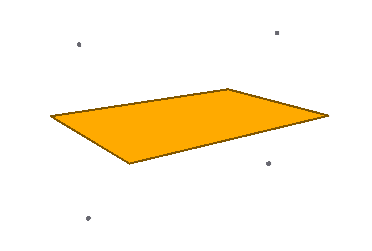

In my environment - Windows 11, FME Form 2024.2.3, the issue was reproduced with the attached workspace example. y and z will be swapped in the resulting vertices as shown below.
orange: input geometry - 3D rectangle polygon, z is identical for every vertex
points: extracted vertices
We will fix the VertexExtractor on the FME Hub very soon; until then, the fix is very simple: open the CoordinateConcatenator and reset the Coordinate Elements to "X Y Z".
