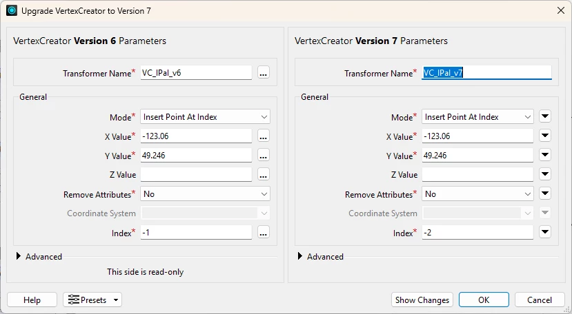

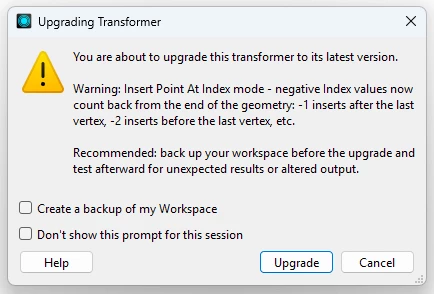

Hi ​@marsol,
The change only affects negative index values with ‘Insert Point At Index’ mode when upgrading to version 7 of the VertexCreator in FME 2026.3.  You’ll get this warning when trying to upgrade:
If the values aren’t set by an attribute, you could manually change them when upgrading to get the same result with version 7 as it was with version 6:
