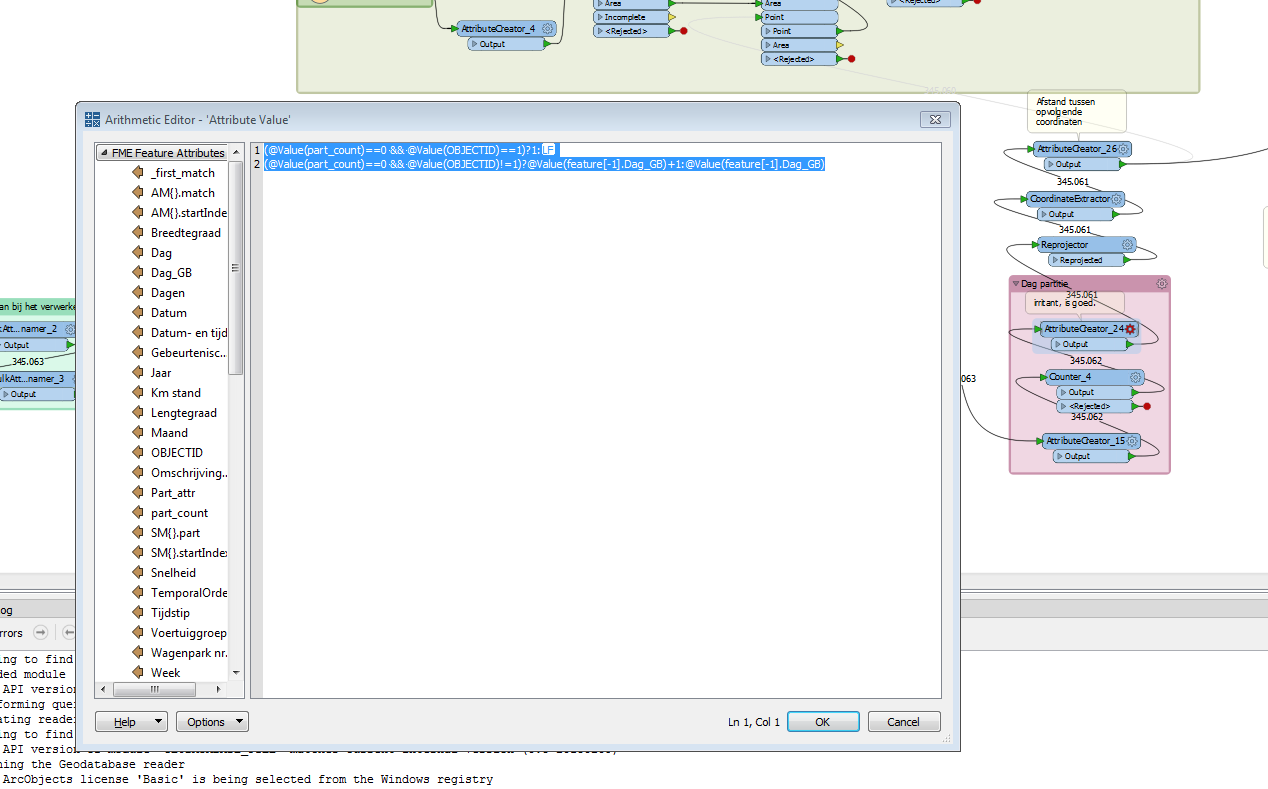

This expression
(@Value(part_count)==0 && @Value(OBJECTID)==1)?1:
(@Value(part_count)==0 && @Value(OBJECTID)!=1)?@Value(feature[-1].Dag_GB)+1:@Value(feature[-1].Dag_GB)
It is a working partitioniser.
It works by first using a counter (counter4 in picture) in group by mode on wathever you want to partitionise. Data must be sorted first (mandatory).
Then it runs the expression on the resulting counter attribute.
This is way faster then aggregating(listbuilding) by group, counting and then deaggregating(exploding).
It is faster because it does not block. It streams nicely.
But the wheels stays red! (attributecreator4)
This is annoying.
A known bug?
(using 2018 B18301)

Update!
Creating "feature[-1].Dag_GB" resolves the red cog, yes.
But it is useless as there is no actual relation to "Dag_GB".
This means that subsequent records do not get updated, but refer to its set value every time.
Only solution is therefore, creating the attribute in a attributecreator prior to the one runnning the expression, so need to create "Dag_GB" with an arbitrary value.
