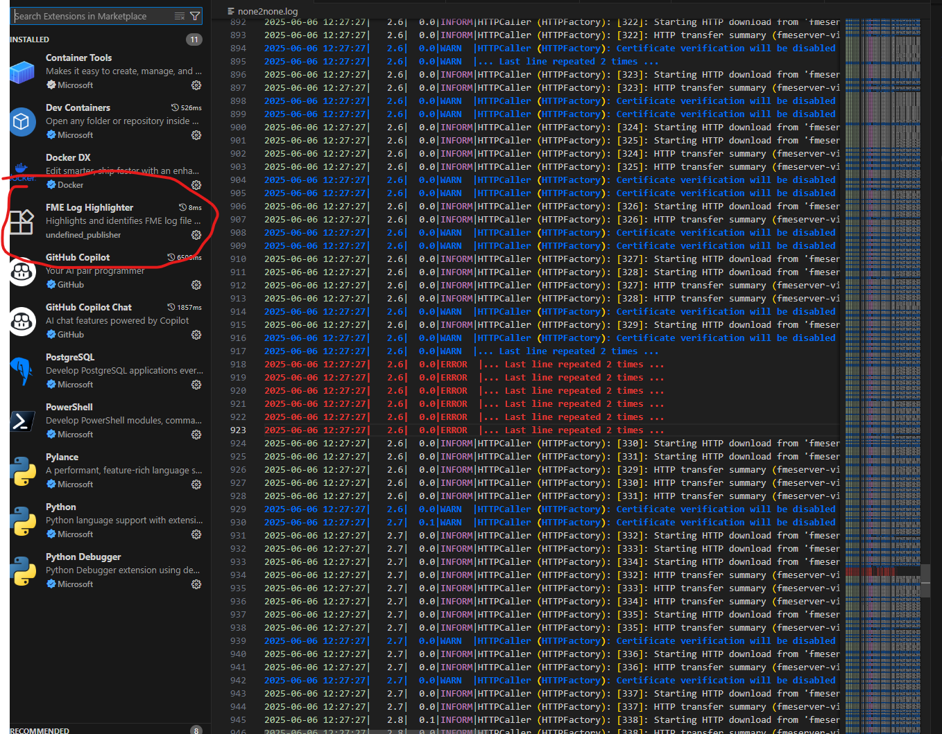

 After that all my FME Log files now look like this
on the left you can see the extension added. I wouldn’t trust what the AI wrote in the description but it does at least uninstall properly.

ok well 45 mins of playing around with copilot I was able to put this together……
To install the extension you should just need to run
code --install-extension path/to/extension.vsix
or drag drop into the list of installed extensions.
To get the typical blue/red highlighting you also need to add this to your settings.json file
"editor.tokenColorCustomizations": {
"textMateRules": [
"scope": "markup.inserted.fme-log.warnline",
"settings": { "foreground": "#0070f3", "fontStyle": "bold" }
"scope": "markup.deleted.fme-log.errorline",
"settings": { "foreground": "#e53935", "fontStyle": "bold" }

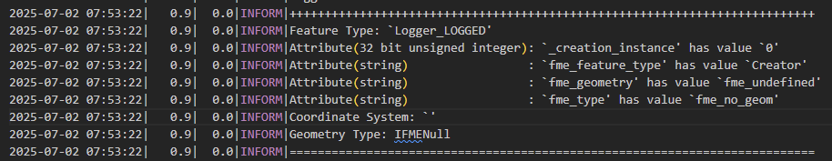

If you’re taking improvement requests, collapsible sections for Logger messages
itsmatt
Forum|alt.badge.img+48
  • Jul 2, 2025 9:00 AM UTC
Nothing wrong with a bit of vibe coding! Looks great ​@virtualcitymatt
Nice idea - the AI has now added some collapsible sections.
I’ve also added a command which will extract lines by status.
use CTRL+Shift+P and look for FME Log: Filter Log By Status
