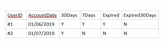

I am currently trying to explore within FME where I can get information of an account expiring beyond its 90 day period or close to expiring based on the AccountDate Field I have below.
I have managed to use datetimeconvertor and then used attribute manager to create 30,7, expired and expired30 days columns. I have also attempted to use the tester with following parameter @DateTimeAdd(@Value(Date ) ,P90D) but this has still not given me the result i was after.
What i am trying to get FME to do is to populate the 30 days, 7 days, expired and expired30days columns with either a Y or N based on the account age which is a range of 90 days.

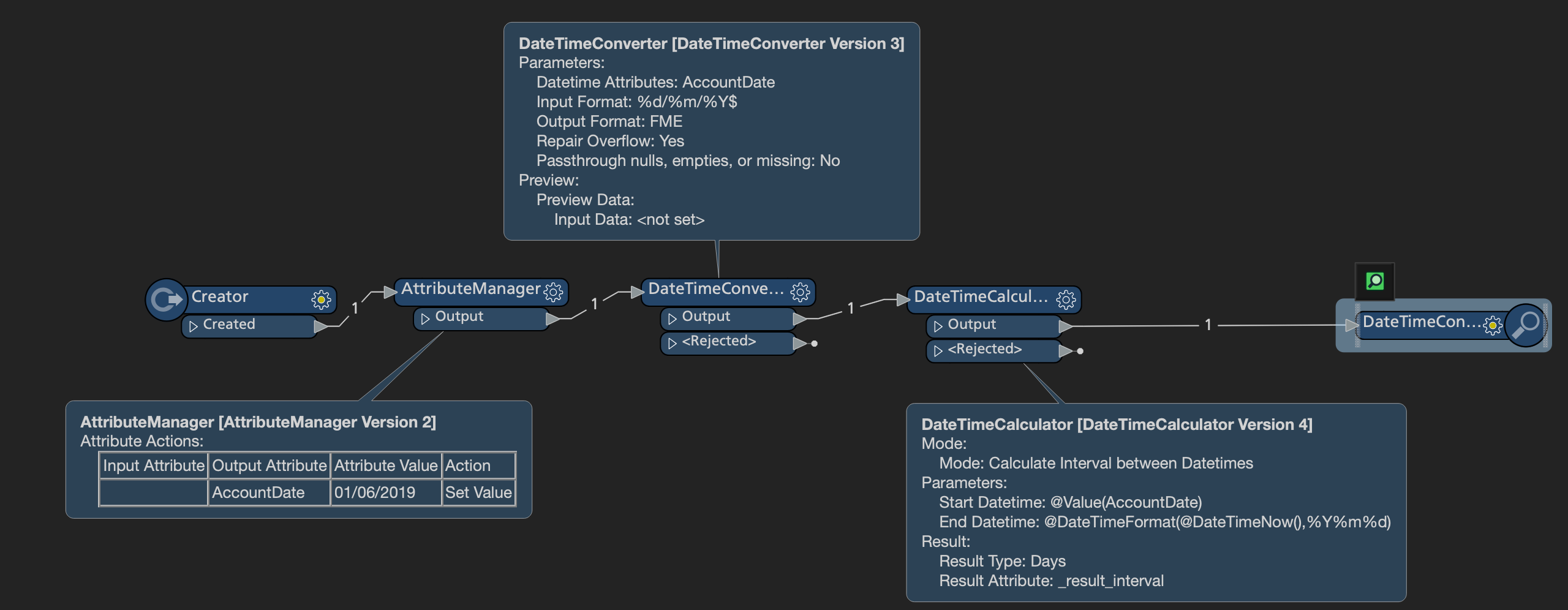

You'll need to convert the AccountDate to an FME Date (e.g. 20190601), then you can use the DateTimeCalculator to calculate the difference between that and the current date, like so:

Thanks in regards to that issue it works for the date.

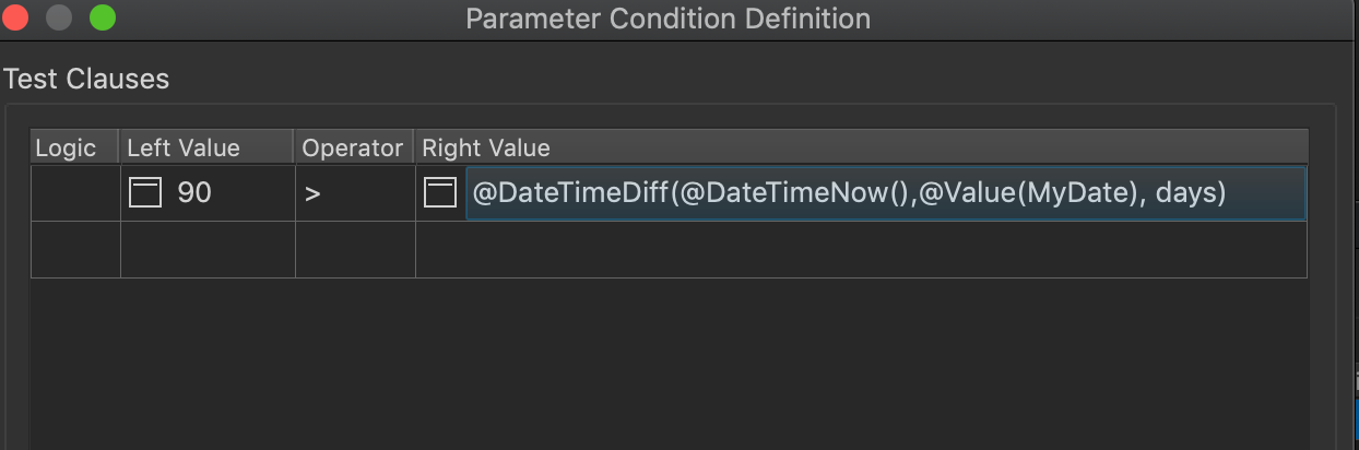

Based on the date column, I am trying to populate if the account has less than 30 days remaining in a 90-day cycle. The parameters I have played with a few different dates but I am only getting a Yes output.
I have tried the below but even when testing with 90days I am getting no output along with tester it's passing fine, so must be something in my conditions which are not correct.

I would actually expect this to always return NO (since your date is always going to be less than that date plus 90 days). Instead, try DateTimeDiff:
