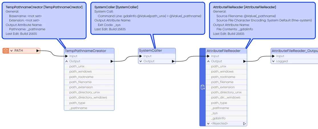

Hi ​@esietinga You can redirect the output of gdalinfo in the SystemCaller to a temporary text file, then read that back in with an AttributeFileReader or FeatureReader:

If I replicatie this on my machine I only get this response in the logfile:
'gdalinfo' is not recognized as an internal or external command,
operable program or batch file and the systemcaller only outputs a code 1 indicating an error.
Clearly something extra is needed to use gdalinfo. So the question may be be: does an fme installation include gdalinfo and if so are there extra steps required to make use of this, or do we need to use a separate install of gdal to use in this process?

You need to install GDAL - the SystemCaller is the way to run programs that are not installed with FME.  See https://github.com/domlysz/BlenderGIS/wiki/How-to-install-GDAL

So FME does use gdal drivers to read and write certain fomats but does not have the full functionality available. Good to know. We'll have to see if i can convince it to make the full gdal available to us.
