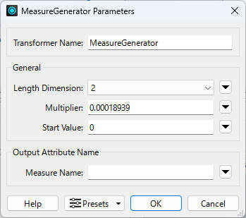

I have been able to extract polylines from esri fgdb, combine the lines into one record but I cannot seem to figure out how to now recalculate all the M-measures in that line.
In arcmap I would manually use the Route Measure editing tools, Set As Distance to 0 and Apply Factor of 0.00018939 to recalculate the line M-measures in miles for the line.
I couldn’t seem to get the measure transformers to get the result I was looking for. This was probably user error.
Thanks,
Ryan
Best answer by takashi
Hi ​@ryan_k ,
I think MeasureGenerator transformer (Multiplier: 0.00018939. Start Value: 0) could help you.
takashi
  • Apr 21, 2025 5:16 PM UTC
Hi ​@ryan_k ,

Thanks, I had used that transform but it didn’t work has expected (user error). It did this time.
